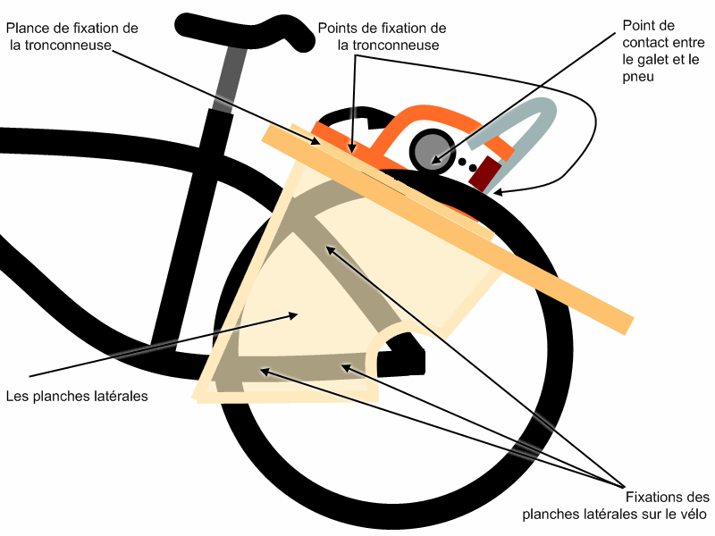

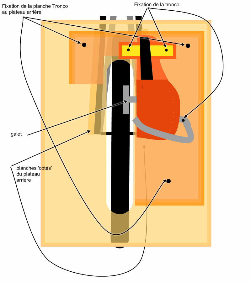

I built the CicloTRON first, it was realy simple, with a friction drive directly on the clutch. And because at this time I didn't know how to weld, I build it in wood.
The engine is a Sachs-Dolmar 112, 52cc, ~3HP.

And we recently rebuild the CicloTRON to make the CicloTRON reloaded. We used the same chainsaw but we added a reduction before the roller.
