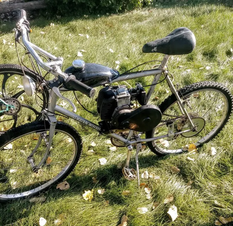

Hello all, I an 1 year old to gas bikes and have 2, 1 is 2 stroke and other is 4 stroke. both I bought used and both had problems, now I am throwing more money at them at getting it going even better, Anyways, Hello all!
