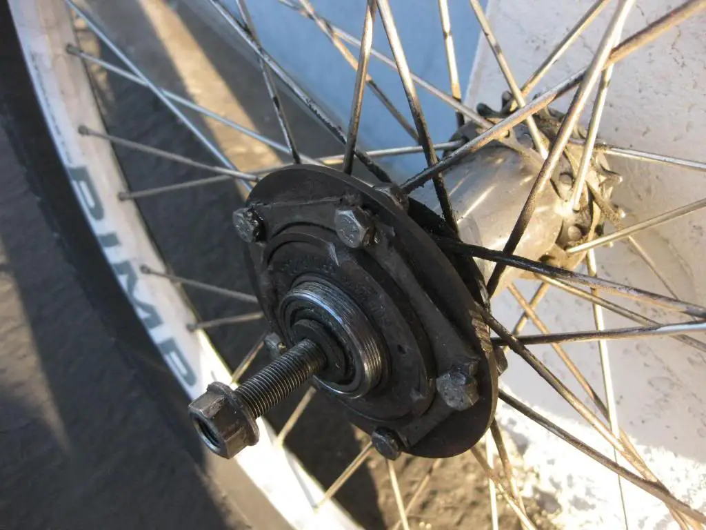

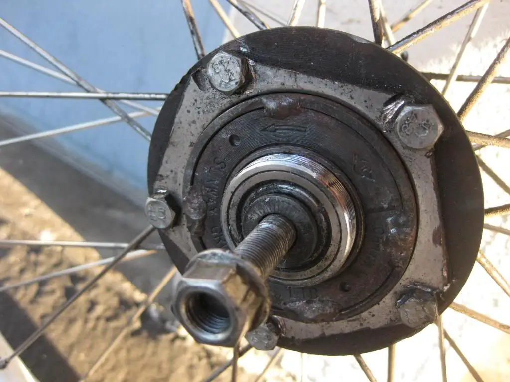

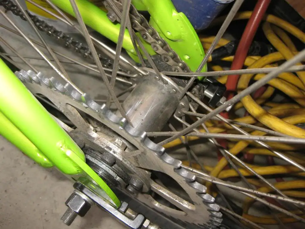

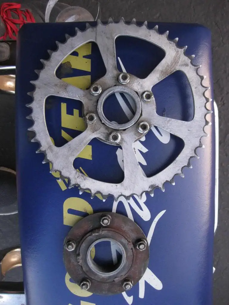

Here are a few pics of both the non-freewheel 6-bolt.......and the freewheel 5-bolt (welded not to freewheel).
The 6-bolt non-freewheel flange:
The 5-bolt freewheel flange (welded not to freewheel):
Get the picture?

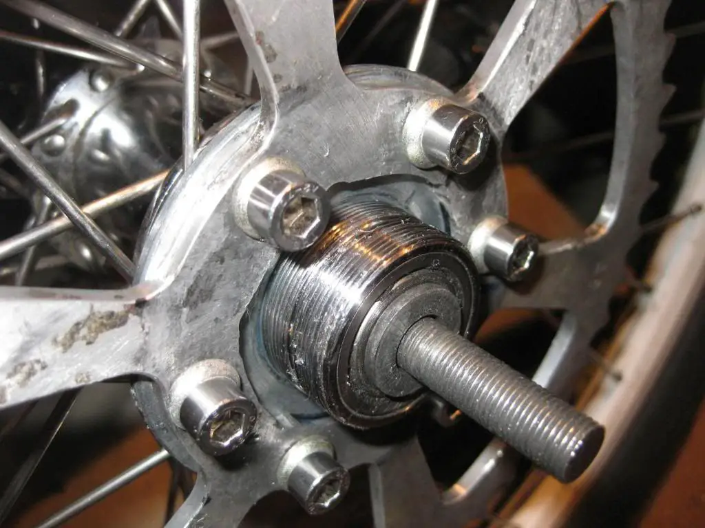

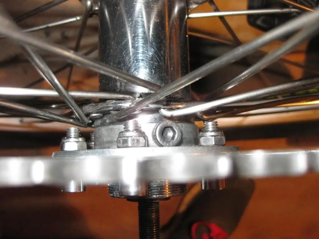

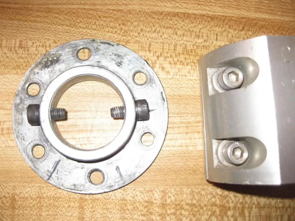

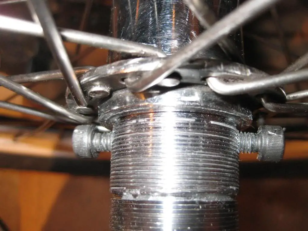

I finally got the stripped thread problem fixed for good. I drilled two holes opposite of each other on the flange with matching holes drilled into the hub which I tapped threads into.
Bolted the flange to the hub using lots of loctite on all threaded surfaces and then bolted the sprocket onto the flange using stainless bolts with stainless nylock nuts. Done deal.
Bolts into the flange....
and into the hub....
and that's how ya do it....
