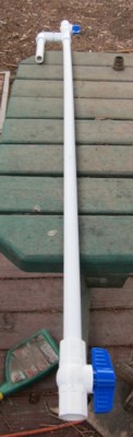

Half inch PVC pipe, a couple of valves, a T and an elbow.

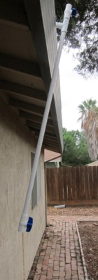

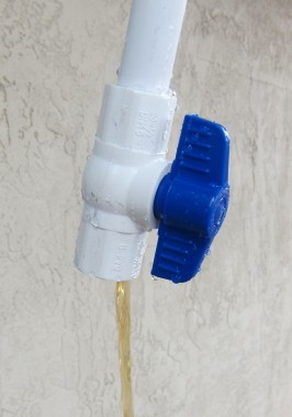

You close the bottom valve, fill the long pipe up until it comes out the short pipe, shut the top valve, put it in the gutter and open the bottom valve.
There is enough water in the long pipe to start the siphon even with the gutter pipe full of air. And it's so easy and you don't have to "suck the hose"
Gutter water that is no longer in the gutter - :)
