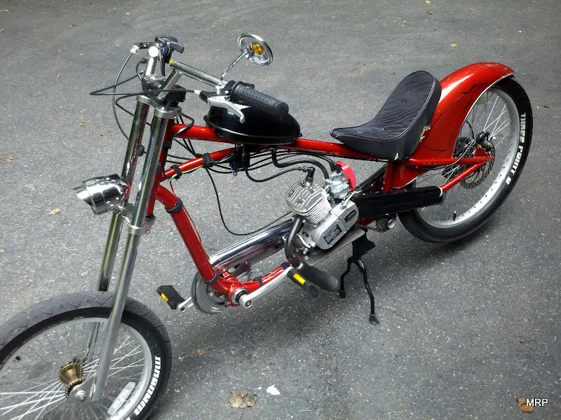

I am having the same issue with the carb on mine. I just can't seem to get it running right. I was running rough at start, then a few days later it was running perfect. Now it is back to running crappy at WOT and bogging down.
I was just out playing with it and it seems like it might be starving for gas at WOT. I pulled the choke a little and it seems to straighten it out. But then letting off the throttle, it craps out. Any ideas?

MrPowers : The major problem with the CNSv2/GenB (red air filter) carb is the seal at the intake. There is an inherent air leak around the outside of the seal due to the junk white plastic shim/spacer. Seal that first, then tune your idle, then set your throttle needle.
Here is a pic of my install.
If you haven't gotten your carb problems worked out, take a look at the thread I just posted about what I did to get mine working. While tuning I had several sets of problems, mid way through tuning I was where you are at now, bogging at WOT and starving for fuel, choke helps get her going a bit. I detail what I had to do with my float, jets, and needle to get rid of the bog. From what you describe I think you can skip past the float and check the jet size and make sure it is unobstructed to fix your bog at WOT and then adjust the needle if you still bog mid throttle. Read the entire post for more details...

The plastic spacer is not the seal, it simply holds the carb in place. The black rubber thing inside the carb at the end of the neck is the seal. When you put the carb on the intake slide it back as parallel with the tube as possible, then when it gets to the end kinda move it around a little while pressing to make sure the intake seats on that black seal that last little bit. I always press the carb firmly onto the intake while I tighten the screw to make sure it gets a tight seal.

Do you have more pics of your setup, especially without the chain guard? I love that frame.
