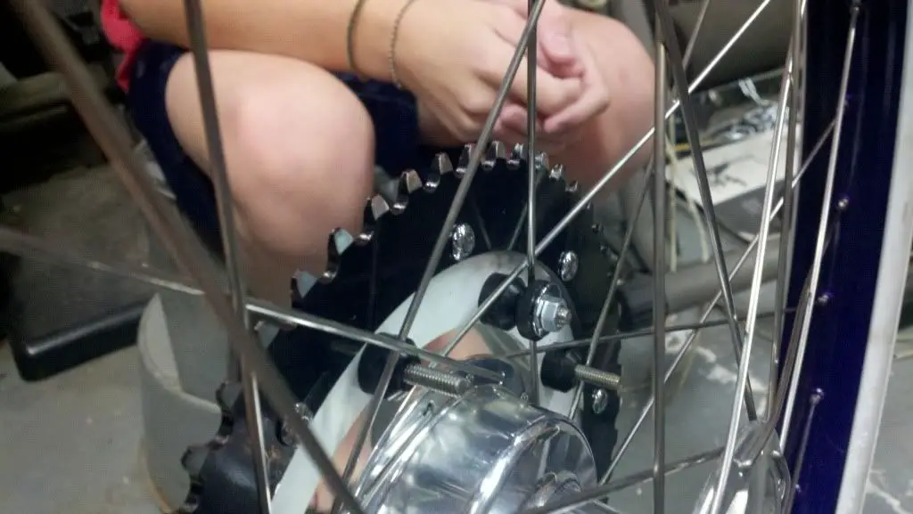

Can I mount a sprocket/rag on this large hub? I figured if I just cut the sprocket center hole larger ( much larger) I might be able to get it on there, like a sprocket ring more than a normal sprocket. anyone attempted this? I cant imagine there is a sprocket adapter made for this.
I see no problem with cutting the center hole bigger. Hey, I have a sprocket welded to my hub. It's nice they are made out of steel.
looking through some older posts I find:
http://motorbicycling.com/showthread.php?t=35573&page=2
http://motorbicycling.com/showthread.php?t=36095
this can work.
thanks mrfixxit
although, I don't quite get the way its mounted I'll figure something out
