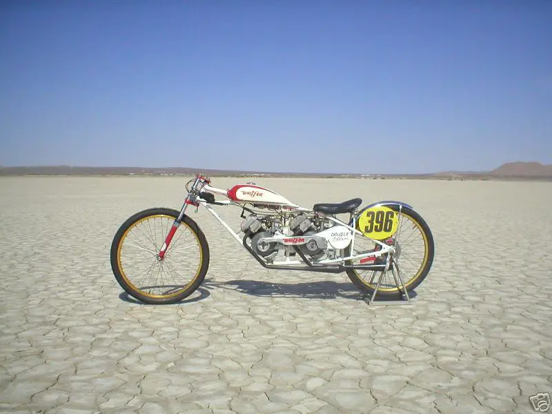

Someone some time ago ran a double engine Whizzer @ Bonneville. I saw a picture of it in a newspaper. I don't remember if it had pedals or not. It was a record breaker in some class or another. 93 +/-MPH? Memorys will fade.

oh yeah, forgot about the twin engine whizzer. 59mph one way and 61.5 the other:
http://www.angelfire.com/pa/whizzermotorbike/Bonneville.html
