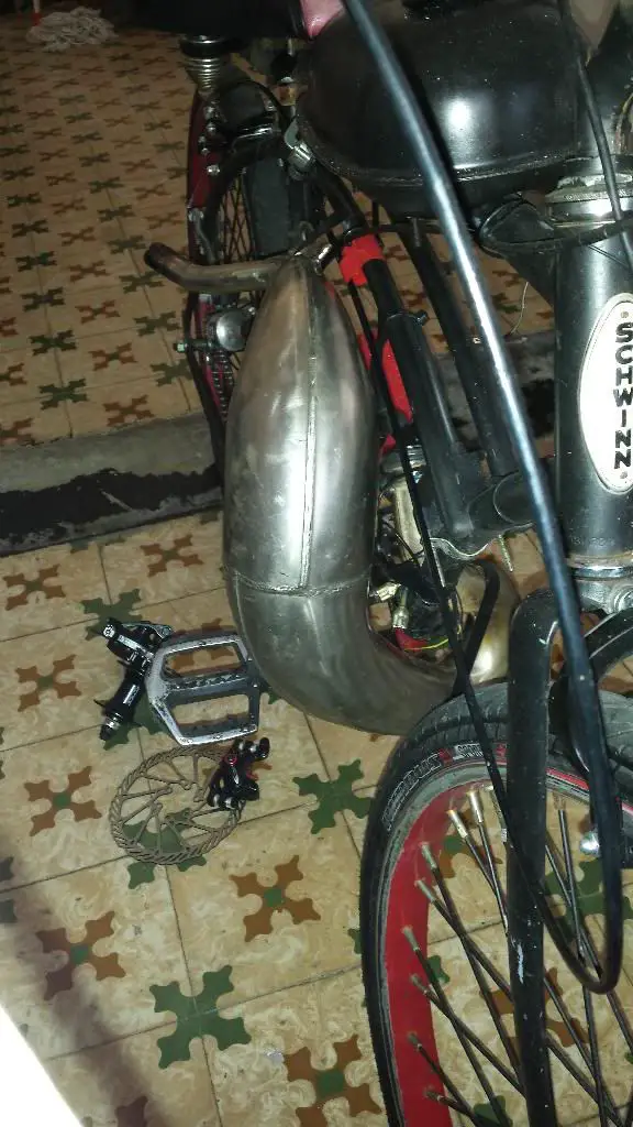

I'm starting to like the look of the KTM50 expansion chamber, was looking at the KX60 but the KTM has that extra bend right where I need it to fit my tiny frame.

That 65 pipe is a bit longer in the belly than the 50 pipe, should be better.

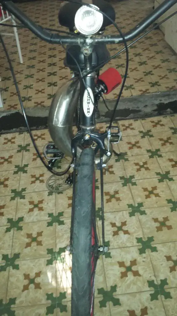

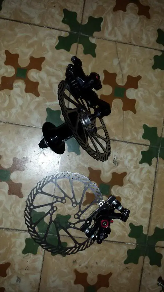

looking good, you will likely have to change your front forks to get that disc to fit.
What hub are you using on the back?
The front wheel clearance is .75"... the clearance from the caliper and the chain on the rear sprocket is like 1 or 2 mm if tje chain get loose it will damage the caliper... for the front fork i need a custom bracket welded to the fork the clearance of the disc and the fork is ok
Those clearances should be fine, just inspect everything regularly and don't let the chain work it's way loose etc... I've run close fit clearances like that on my Harley for years with no trouble
