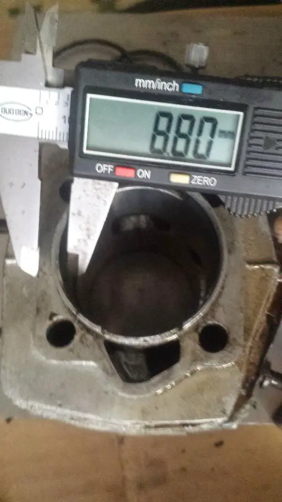

Al you need to do is to block the intake port to reduce volume @ crank case and make a 3rd transfer port the same as the other 2. Also the intake port area needs to be 3.2cm^2 for 9k rpm. You are going to go 180 degree @ intake this reduce the intake area because the area is going to remain constant all the 180degree. In the cylinder port you have mean area is like the half of the total port area because the area is going to change during the duration period is going to increase and then decrease this is why the mean area.

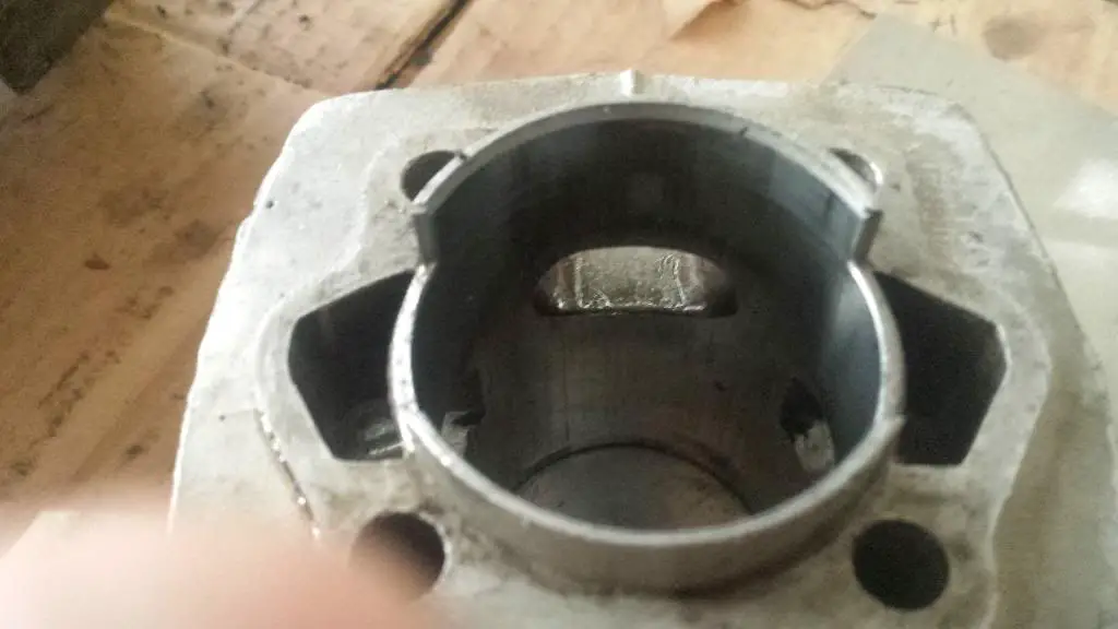

The luck is on my side, this weekend the engine run faster than ever, reduced vibrations.... Then the engines loose half the power and need to be at high rpm to stay on. Today i opened the engine and a piece of steel make two " boost port" style grooves in each transfer port to the top of the cylinder. I check the piston rings and they are ok, check the wrist pin bearing and it is ok. The steel piece must came from below. I need the special tool for open the engine to give a look. Now i need to rebuilt the whole engine....

You need the duration for all ports and the mean area, mean are is the area @50% of the duration from port opening to BDC (transfer ports and exhaust port) for the intake is from port opening to TDC
