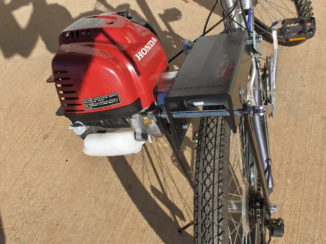

Here's my Staton with a Robin 35 on a Mango Toucan 3.
I removed the stock tank and put a bigger one on the other side of the bracket. Looks a bit better balanced eh?
These are never gonna look as cool as an in frame, but they are simple and reliable and Japanese motors are better than Chinese motors. Even so, I think this came out pretty "smooth"
