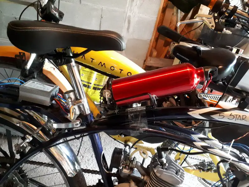

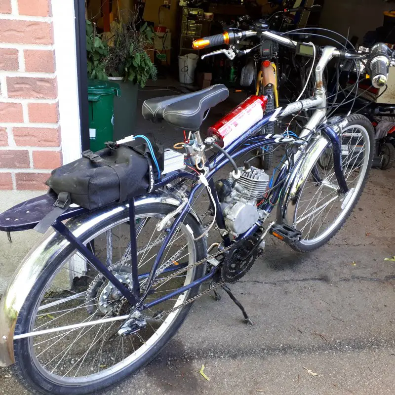

Ever since I did my first gas bike kit installation I have been searching for ways to get rid of tell tale gas tank and now I think I have found it. The Water Bottle Tank!
Now the next problem is to find that perfect place to mount it.....any ideas welcome.

What size hole did you drill for the petcock. I’ve got a leak in the stock gas tank and I’d rather not buy another dud
Davideo
Feb 25, 2020
171
169
43
87
I just measured the petcock thread diameter and used one of those step drills to make a hole in the bottom of the bottle, liberally smeared JB Weld to the threads and around the hole inside and out, then screwed the petcock firmly into the tank. I have been checking it regularly and so far no sign of a leak.
