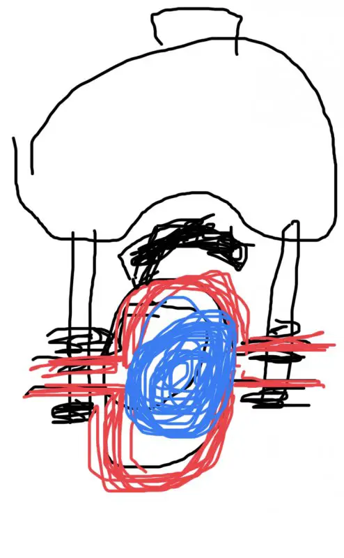

Clamp top tube with two straps and more nuts and put a piece of rubber between tank and frame in center. Don’t pull on the studs or you will develop a leak that will scrap the tank.

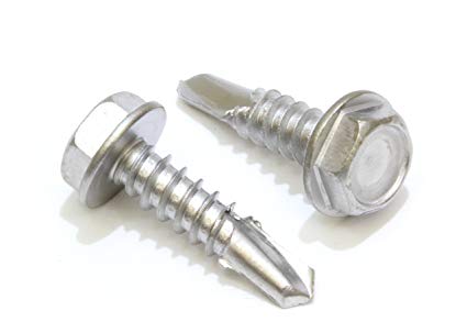

Use a piece of inner tube under the tank. I drill a hole and use a self tapping screw through the U mount right to the frame. Gets it so I don’t have to tighten the nuts to much or it could cause leaks. Also recommended applying a healthy dose of jb welt to each stud mount point right off the bat for extra rigidly.
What Zelda said, Put a self tapping screw thru each of the U clamps and right into the top frame.
It will never move again
