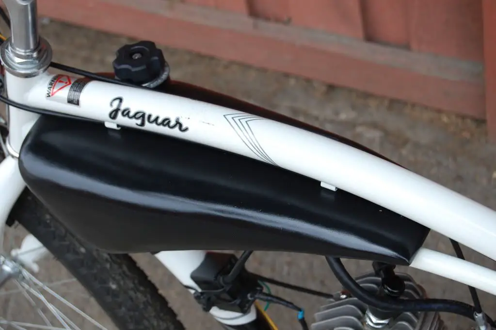

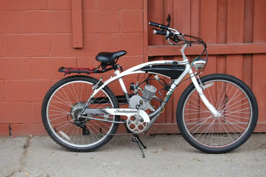

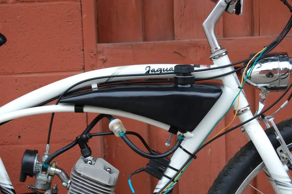

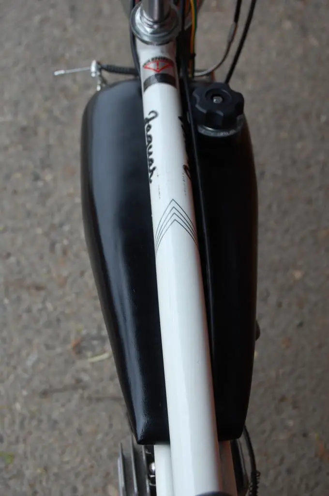

if you use the right sealer fiberglass is the perfect materiel for a custom tank, easy to form into any shape you can dream up without the need for expensive equipment, or metal forming skills.
i offer a how to step by step DVD on making fiberglass tanks.
some bikes i made fiberglass tanks for.

Those are really nice fiberglass tanks. I am in the midst of my rebuild right now and am just about ready to start building my custom tank. My frame is a 3G cantilever style frame but is streched a bit so a standard in frame tank is not an option. Instead of going that route I am going to frame the tank off the bent down tubes and top tube to fill in the area between the two, when done it will be an actual welded in part of the frame, should be nice. I will post some pics soon.

OK.... So fiberglass is bad, but now fiberglass is good. So, what is the right sealer? Kreem?
