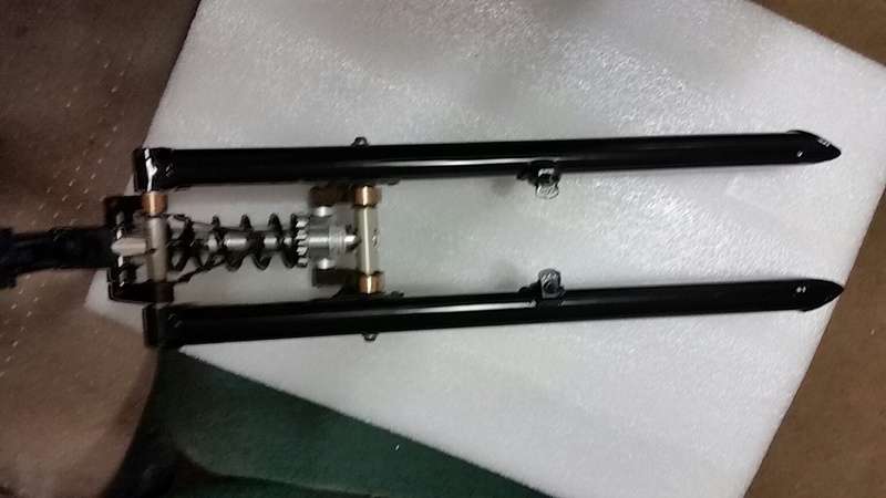

I bought an older Girvin / Noleen front suspension fork for mine and converted it from an elastomer type dampener to a regular oil dampped shock and it's a night and day difference in both smoothness and stability. With this front end I can take my hands off the bars at 40mph and the bike will just keep cruising straight. Going over rough roads , hitting pot holes or hard bumps doesn't even phase this thing either.
If you can find one of these on ebay that's in good condition and at a decent price, they're well worth it...

I find them on ebay from time to time and they usually cost around $200 for a good used one and the price can go up pretty high from there since these were only made for a few years back in the early mid 90's. I actually got mine for $125 but the elastomer was worn out and it was just a gummy mess so I bought the spring to convert it to a spring suspension and since the oil damped shocks were very rare and very expensive if found, I used a go kart shock that was the right dimensions, removed the go kart spring and put on the conversion spring, then had to ream out the mount holes on the shock it's self to 5/8" to make it fit. I then cleaned it all up and painted it before installing on my bike but it rides just as good as a high end downhill front end, has about 3" travel, and costed me right around $200 after everything was said and done.
Other options for a good front end are like someone mentioned, certain moped and small dirtbike front ends will bolt right up to most bicycle head stocks with the 1 1/8" threaded or threadless setups.

I had to type in "Noleen" and "Girvin" in ebay's search box on bicycles for about a month before I was able to get one, then I bought mine and 3 more popped up... 1 was pretty much trashed, the other was for around $200 and in nice shape with the spring shock conversion already done, then the third one was in England and it was high dollar because it had that electronic shock on it so it sold for around $500
I was lucky to find one for $125 plus shipping when I did.
Yeah, the whole reason I got it is because of the girder design, there are other designs that can be made to work really well, but the girder design is a long proven design in motorcycles since the 30's or even earlier, and they made a really nice comeback on Harley choppers back in the 70's..
