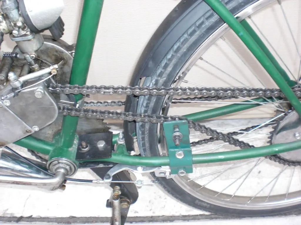

I got this idea from another member. Bolt a rear caliper BMX brake to the cross piece on your chainstays. If your frame has no cross piece there, use a couple steel plates on the top and bottom of the chain stays as a cross piece (just drill holes and clamp the steel plates in place). It has worked well over the past six months for me.
