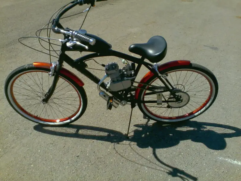

that 24in bike looks like a tight fit for motor - can't quite tell from pic if rear wheel has 36 spokes if rag joint will be used for rear sprocket - 24in wheel will be a LOT slower than a 26in wheel
as side note, at my shop, I refuse to build a coaster brake bike
I blew the picture up and looking at half of the rear wheel it looks like a 36 spoke wheel, good advice to check the wheel crassius.

I recently built a kent bayside - about $100 new at walmart and sometimes on sale at $79 - reasonably easy build, fairly comfortable to ride - brakes are a bit soft tho

the one I showed the pic of is easy (very few decisions to make on getting fit right) - the brakes work well enough to get used to it while thinking of better pads or a simple bolt on of a nice tektro clone on the front

That's a nice looking bike! I got the flying horse with the black finish. It seems like most of the beach cruisers out there or a steel frame with steel Forks. They all seem pretty solid. I don't think that I can go wrong picking up any of them that's in good condition. The ones that are the most available are the Huffy's and the Schwinns. Is there a quality difference between those two? Also, I can do spark plugs and wires, change my own tire, do break pads and I did a starter once. I've always done all the repairs on my kids bikes and skateboards. I was a single mom so I did all that. I do basic home repairs. I think that putting the bicycle engine kit together will probably be more complicated than any braking system I might paid. But I don't know cuz this is my first one.
