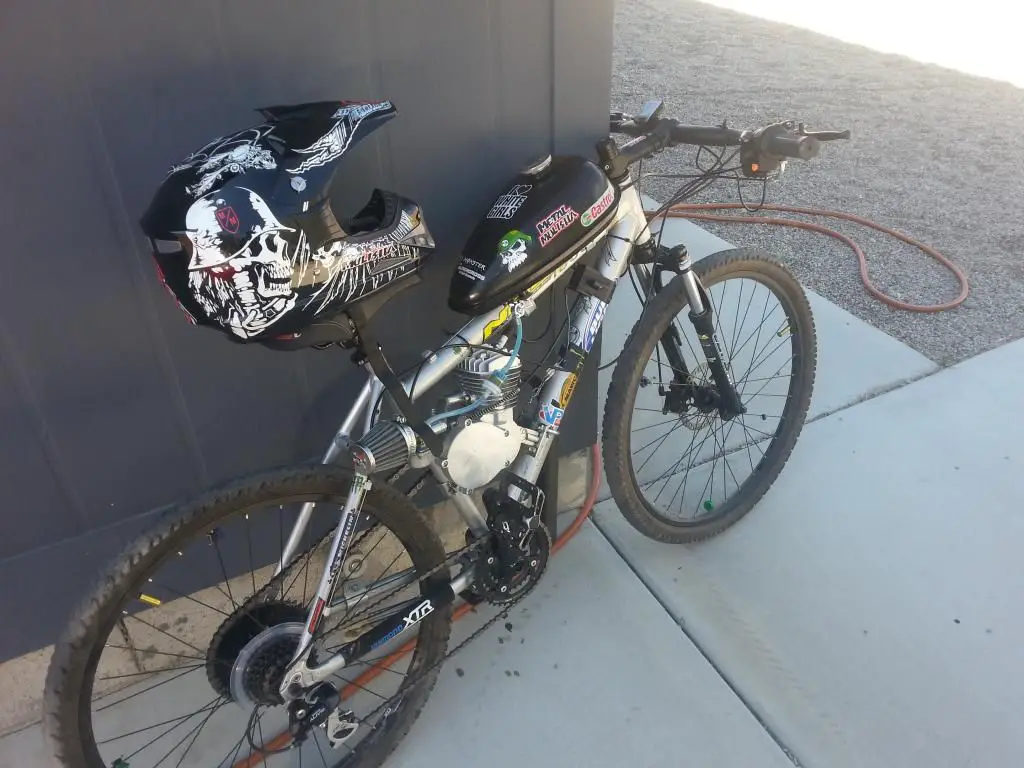

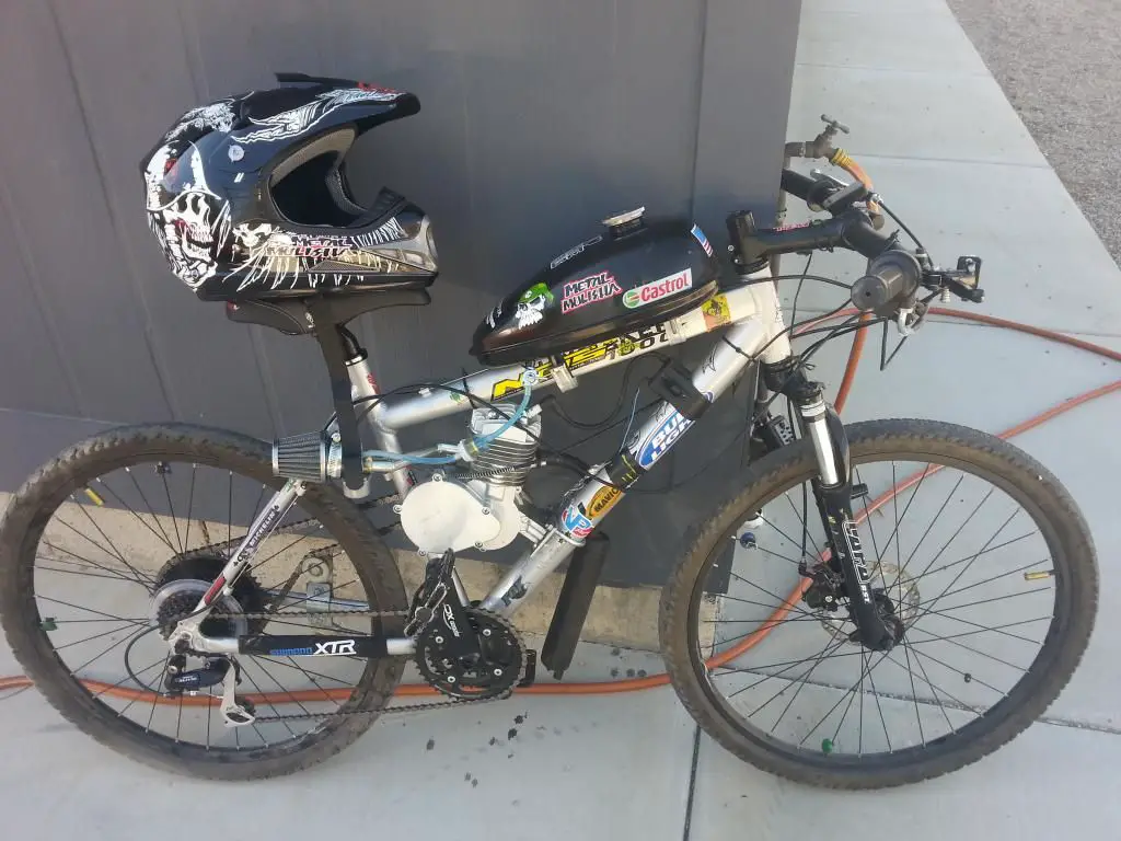

Replaced Front 160mm disc rotor with 203mm, took two tries and an order from China, but, I finally got the right adapter and didn't payment moreover than $5 for it.
If the 255mm conversion wasn't so expensive I'd have those, but I don't have a hundred bucks.
Found a beach cruiser center mount style brake for the rear, installed it. I'm deciding if I want to keeps the dual pull lever or go with an extra lever one the left. I feel I have more control within two brake levers and a clutch.
Found a cheap RT carburetor to replace my NT that leaks profusely and acts erratic all the freaking time.
I used the stock NT jet, I have micro drill bits, I'm just waiting on a battery to use my digital calipers.
Noticed my Offroad, on road adventures have wreaked havok on my tires, only 400 miles and they look bad. Going to need at least another hundred miles out of them though. I'll probably pull the new tires off my old mtb. Since it's just sitting.
I've opened the exhaust and intake manifold, cut the tube out of the exhaust and matched the gaskets.
Im just gonna come out of the blue and ask, (because i thought i saw it on your parts list in the beginning of this thread)
Are you going to run a Jaguar CDI??????? those things work wonders for your powerband dnut
Dope looking build btw, sorry im late lmao. but yeah
I'm running a rocket racing cdi, it works great and it was cheap.
Over 800 miles so fa, added a Rutoung carburetor, new rhinolite rims, deore hubs and dt Swiss alpine III spokes.
I cruise at 26-27mph on the stock unported jug with stock exhuast.
I'll install the voodoo exhaust when Santa buys me a skyhawk frame for Christmas, as well as a Fred head.
