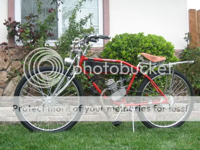

First build check out my worksman
[email protected]
Jan 7, 2011
27
california
SEAT POST IS HOME MADE AND VERY STURDY I'M 200 PLUS IT ALSO HAS 40 TOOTH SPROCKET WITH BILLIT HUB ADAPTER FROM PIRATE CYCLES THANKS JUSTIN
ADDED THE SPRINGER AND A HORN MY 3YR OLD GOT AT WALMART;] BOTH CHAIN GAURDS ARE BEING LINEXED AS WE SPEAK

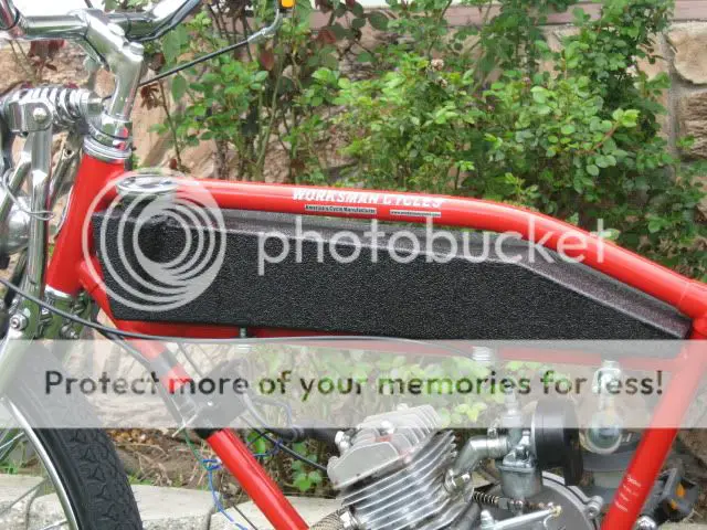

BUILT THIS TANK FROM SCRACHT CAP BUNG AND PETCOCK IS ALL THATS LEFT OF MY CHINA TANK LOL

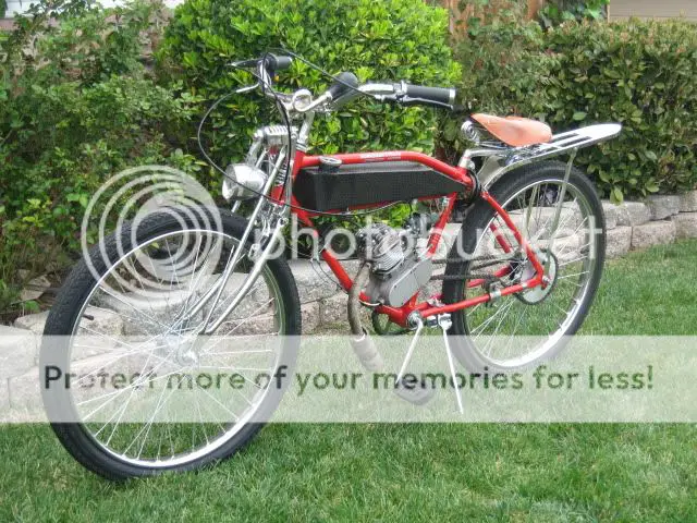

PUT ON THIS BATTERY LIGHT TO FEND OFF THE COPPERS BUT JUST PICKED UP SOME RUNNING LIGHTS FROM BUDDIES FULL DRESSER SHOULD BE PERFECT FOR WHAT I HAVE PLANNED REMEMBER U CAN DREAM OUTLOUD!!!!!!

You picked a good bike for just a po boy ride, my worksman cost about $500.oo and is getting fabbed for BTR by Pat at Sportsman Flyer, that $500.oo was just for the bike. You did GOOD!, like the tank and might I suggest a pair of monark forks in the future, paint em' the same color as the bike

Nice job on the worksman. Someone on the forum had recently asked about fitting a 2 stroke in the frame. Looks real good! Dan

Great looking bike! May I ask which China girl motor you've got on that thing? There seems to be plenty of clearance on yours and I'm having a bit of difficulty finding a 2 stroke that fits as well as yours. Thanks. And again, sweet ride!

zoom but they all fit if u look closley you see a glimspe of the velcro with rubber backing between mount and bar if u do the rear mount first slide motor up intill it clears sprocket then tilt down till front mount touches titened in place just make sure you have some kind of rubber between bars and mount i'm working on some real rubber mounts now
