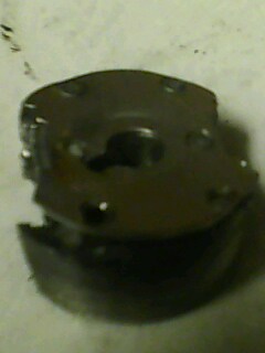

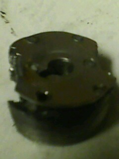

Well, I work at a machine shop and decided to take the bike there today and work on it at lunch time. I took the cover off that covers the magneto. I dont know much about them but I just wanted to have a look since the shop is heated and well lit. When I removed the cover, 3 pieces of magnet fell out. The key maybe? Not sure. The round part that spins is damaged. There is a crack in the metal and there looks to be some seperation that might have been caused by a force. Im not sure what would have caused this but if anyone out there knows, please let me know. If its something I caused, I want to replace it. If its something with the making of it, I want to use my warranty. Also, can I replace just that part?
Thank you very much. Very helpful and sounds logical. The key is broke in 3 pieces so i guess Ill need that. Im going to contact the seller and see where it goes! Hopefully Ill be up and running!

I got the new magneto today and pulled the old one. I took a couple pics and attached them. I cant believe how much damage there is to this. Does anyone know what could have caused this? I put the new one in but dont want to try it until I find out if There is something I should do before trying.
Bummer Denny, sorry to hear.
Sounds like your getting a handle on it and you'll be up and running soon
