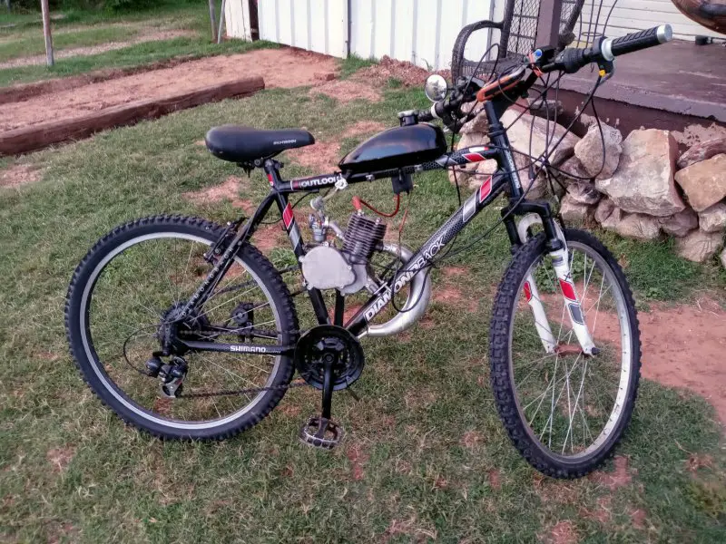

This is a reply to those who fear using lightweight aluminum frames due to cracking issues.
I bought a used Diamondback Outlook mountain bike. All aluminum frame and as light as my road bikes.
I put a Zeda Firestorm YD100 kit fromBicycle-engines.com on it and it will hit 54mph on a
flat road for almost 2 miles. The YD is a torque monster, so even with a 36t rear sprocket, You can take off from a
standing start with little or no clutch slippage. It goes up hills and grades without missing a beat, and is
fun on the trails as well as the road. Here also is a video of it going on the street, and a spin on a local bike trail,
and then on the expressway.

Nice bike,
Debating on motorizing my cannondale killer v500.. Its pinky weight and made with aerospace aluminum.. Would probably be better than my fuji mx600 series.. But the frame on the cannondale is really thick so id need bigger motor mounts, which i dont have atm. But its a sound idea lol

Can't tell from the pictures where's your speedometer or bicycle computer? Only looks like a cellphone is on it.
