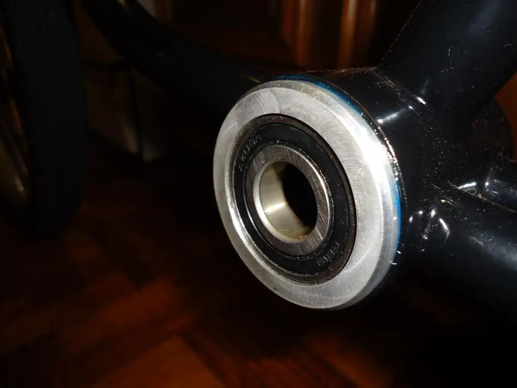

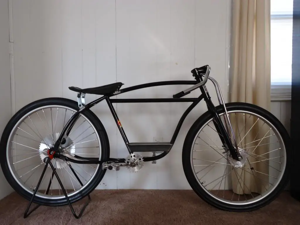

The wheelbase looks a tad long because the rear isn't adjusted or tightened. The forks are just there more or less. For some reason the headtube on this frame is for a 1 1/8" headset and not the traditional old fashion 1". Not a big problem, I prefer 1 1/8'', but now I need to buy a headtube reducer so I can use my monark forks. Overall, this is going to be a fun project.
The frame does have a odd bearing cup size.I have every type out there and had no luck.I bought mine from the same guy on Ebay.I sent him a message and explained my problem..He sent me out the correct bearing cups.

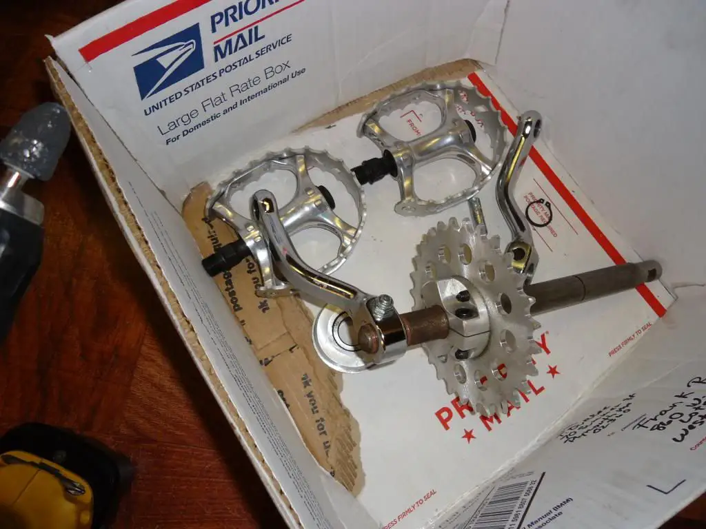

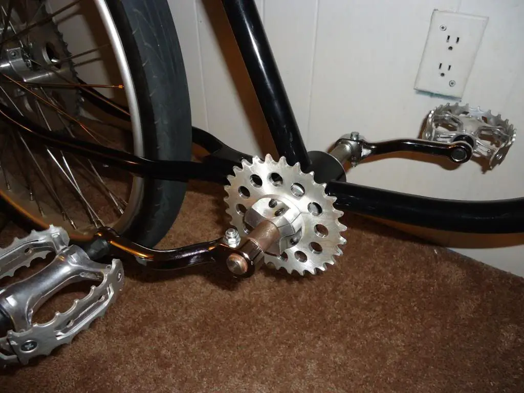

The parts have arrived from Troy (chainmaker). All I can say is that this is a well built unit originally from Pat @ Sportsman Flyer. Install was fairly easy, just greased the frame and hit it in with a rubber-mallet. I really like the snap ring design, this crank can definitely withstand anything we'll put it through. The only draw back is that I'll need to use a #41 chain on the pedal side; very heavy duty but it does add a little weight... oh well.

Don't you just love those 'Priority Mail' boxes? They always contain the neatest stuff.
Looking good, Frank. Let's hope for an early spring. And I don't know about you but I've had enough of this wind!

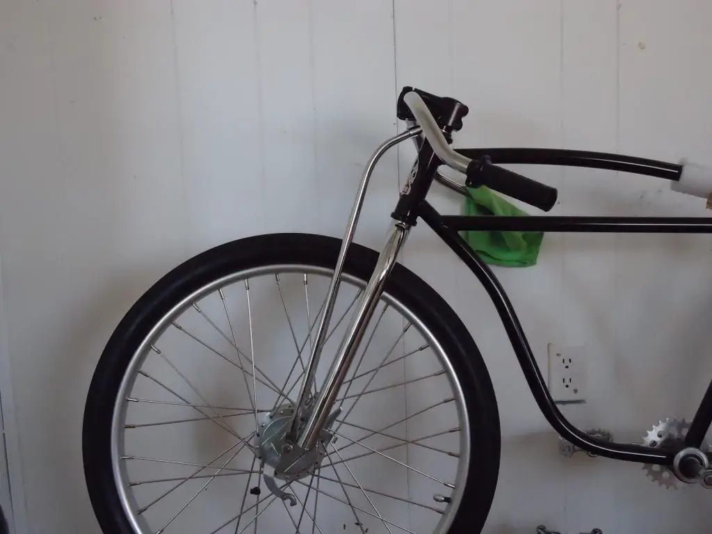

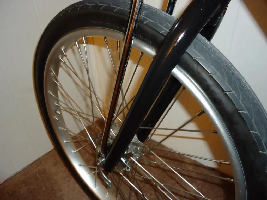

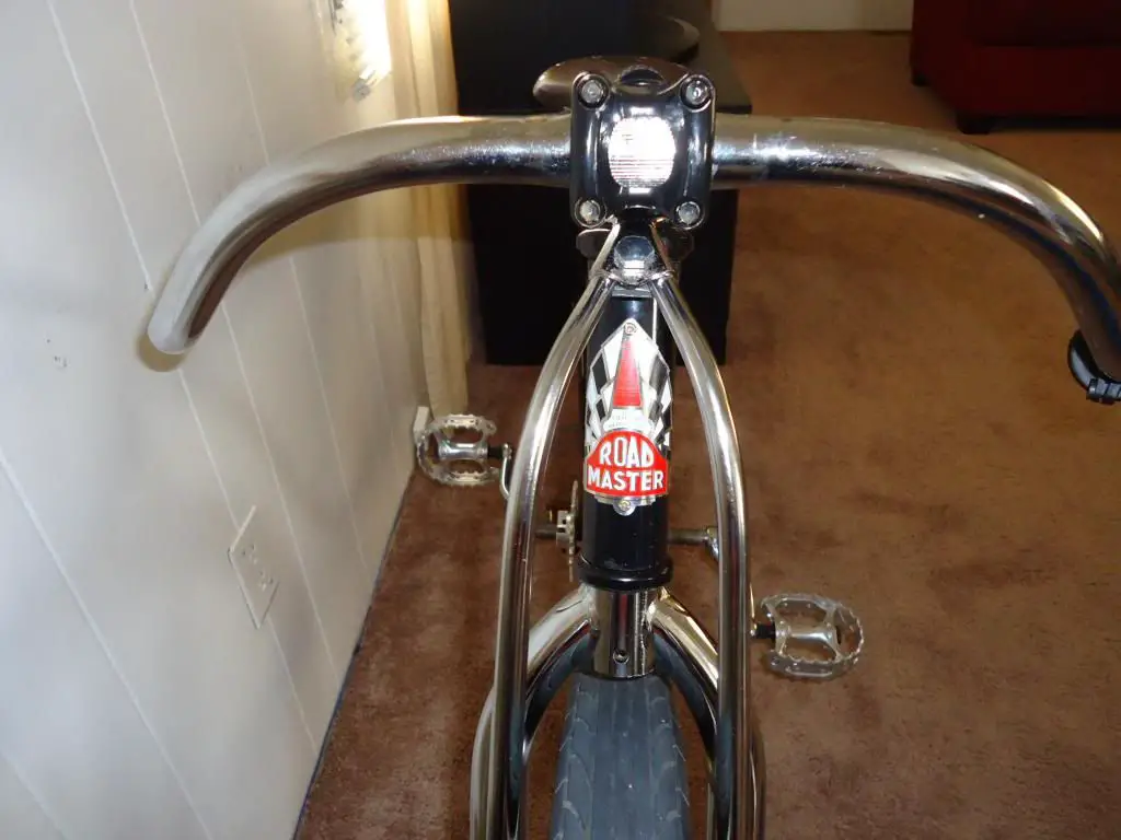

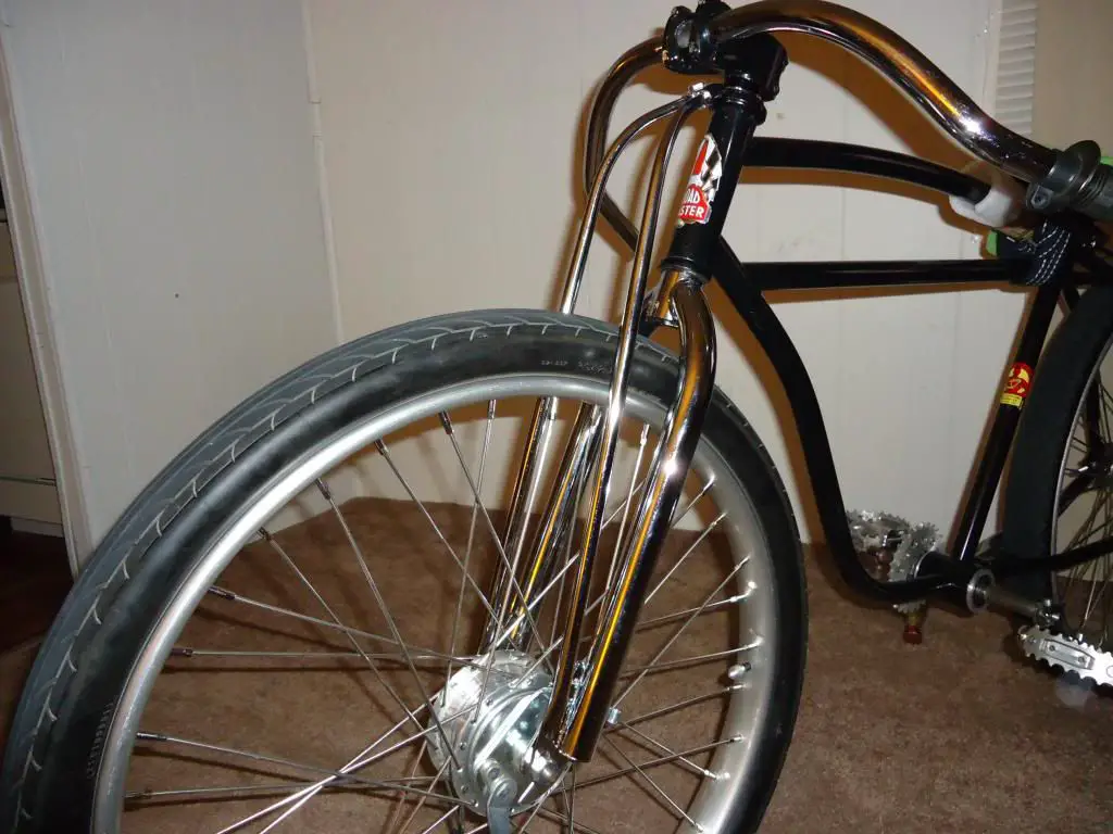

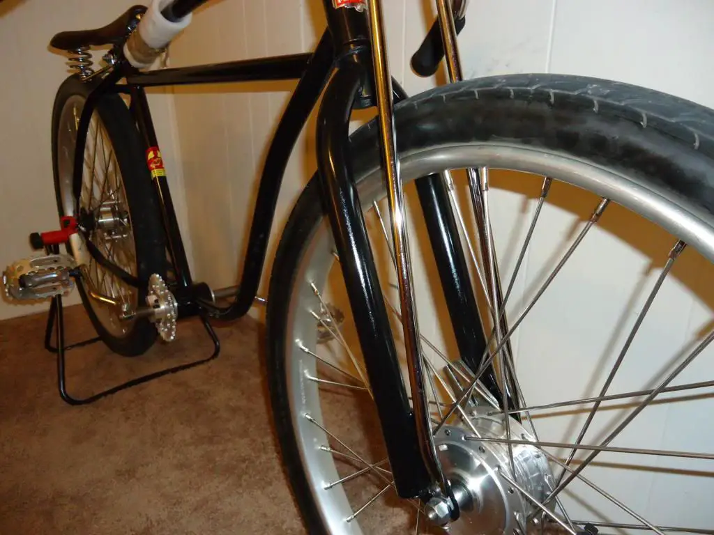

I decided to toss the headtube reducers needed for the monarks. Now, I'm back to the stock headset. Old style mixed with modern technology :) 1 1/8" threadless BMX forks paired up with some old truss rods. I had to mill the truss rod mount hole because it was intended for a 1" threaded headset, not 1 1/8" threadless. I think it looks great, more btr, it's very solid and smooth with the sealed bearings.
Now the weather needs to cooperate so I can paint the forks.

Looks better every time I see it. We'll be watching Frank. Good work on the fork. What are you going to to to that chrome to get paint to stick?

Well we got the first 70 degree day since mid November; so I was able to get some minor painting done on the forks. The chrome was nice, but was a little to much for me :). I'm still waiting for my gas tank from ghetto bikes. I'm getting a little ancy for it... it's been a few days longer then he said it would take. Hopefully this week sometime.

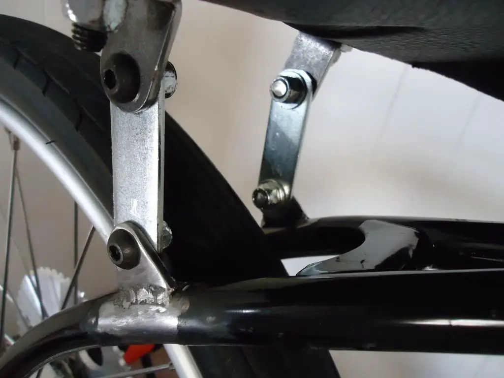

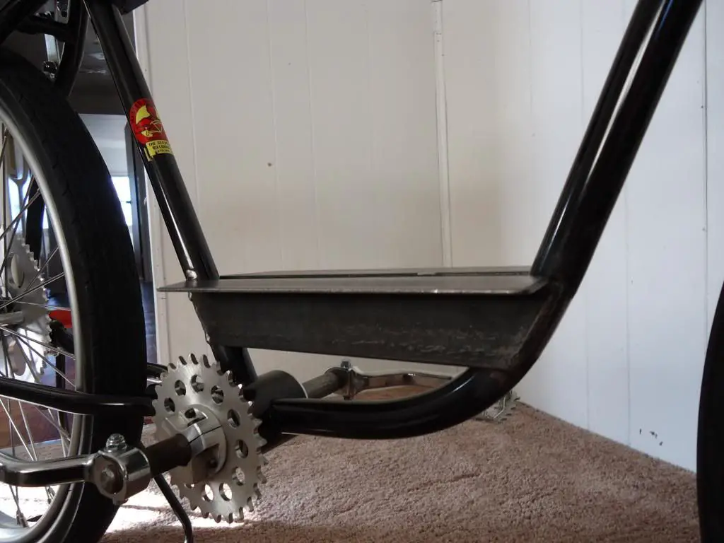

I just got the bike back from my friend Tom (2door) last night. He did an excellent welding job for me this week. Helping out with the seat tabs and motor mount so I can get this thing finished and riding finally. I can't Thank you enough Tom, thanks again. Here is what it looks like as of today, should start making some serious progress now. :)
2door
Moderator
Staff member
Sep 15, 2008
16,302
175
Littleton, Colorado
OMG, Frank, that rear seat bracket weld sure looks better in person than in that photo. The lighting makes it look like chicken droppings :)
And you are quite welcome, sir. Should be a good riding season. Looking forward to seeing that bike on the road.
I agree, the pictures don't do justice. I think I'm going to put some putty like your we're saying and make it look even better. That and then mask and paint tomorrow... weather is going to be good.

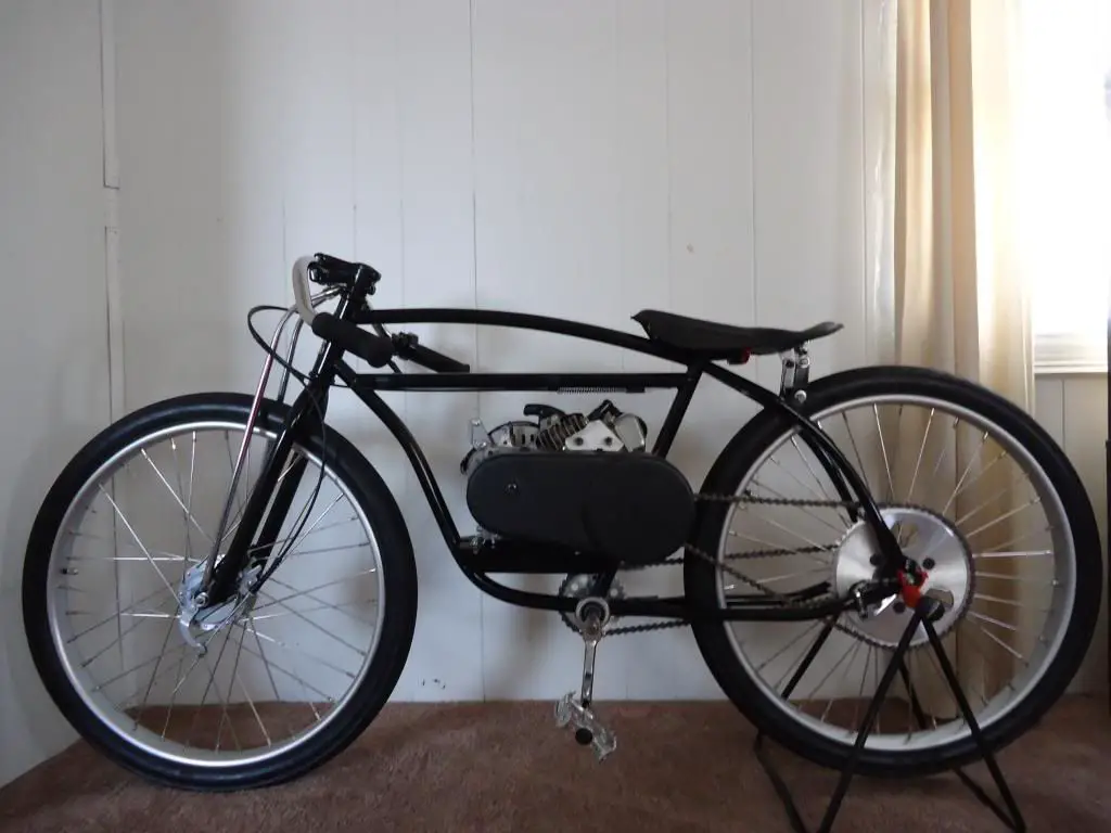

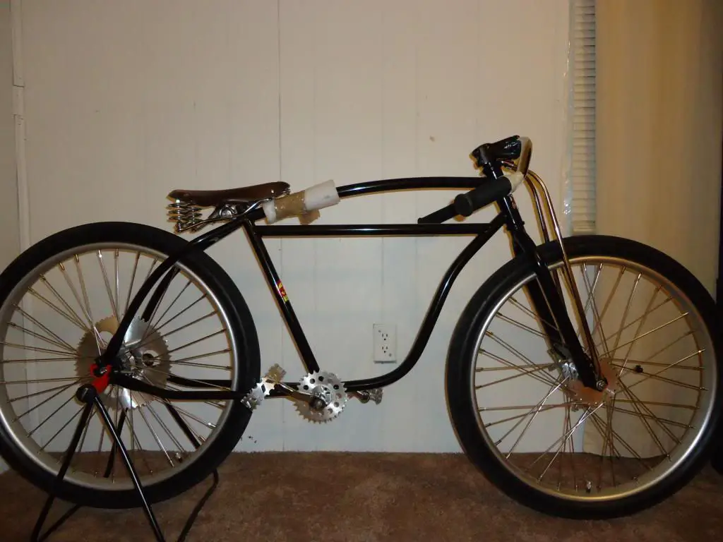

Okay!! The bike rides very smooth and solid as a roller. Now everything is in place and ready to be completed :). Mainly, I just need to do the little things to get it complete: (cables, exhaust, ect). The 2 major things that need to be addressed are: I need to receive my gas tank from James @ ghetto bike. Second, I need to figure out how I'm going to secure the front drum brake arm. I have read about "p clamps" as well as hose clamps failing; and I don't want to be in that category and have you guys read about my failure some day. There are a lot of ways to do it, which way will be best for my bike is the question??? I'll let you guys know what I come up with.
Let me know what you think so far...

Frank,
I have an idea for a nice clean bracket. Too bad we didn't explore it a little further when I had the bike down here.
If I had just the fork and the wheel I'd make the bracket. What is the width of the slot in that arm. If I recall it was about 5/16 to 3/8" ? And how much room between the arm and the fork? Any, or does it touch?
