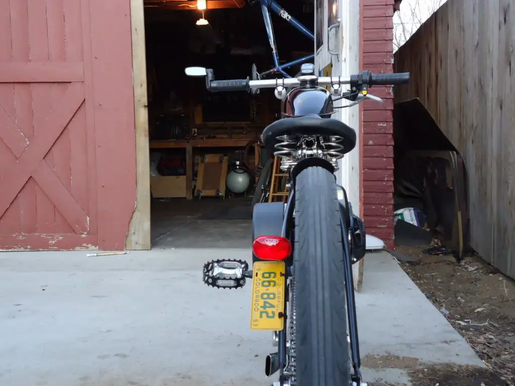

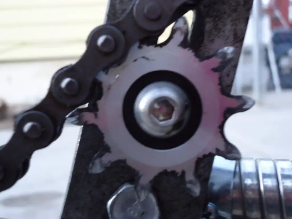

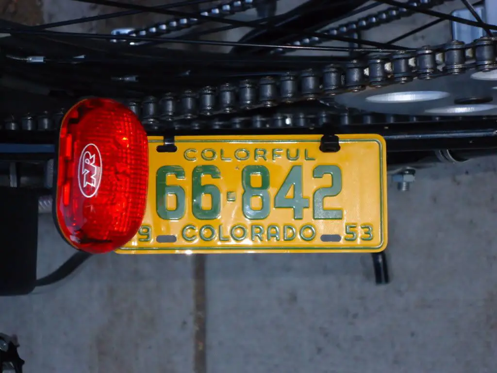

Okay, so here are some more pictures that I mentioned earlier... I received my seatpost from Pat @ Sportsman Flyer. It gives the bike a sleeker look and is functional as well, it placed the seat right where I wanted given that I'm a taller rider. I put on a classic Colorado bicycle license plate from 1953 to give the bike just a little pop of color. I also installed a 10T sprocket idler roller, rather then using the plastic kit wheel. I still can't figure out which way to go for a headlight; I've just been using my pedal bike lights for the time being, but they are not bright enough to use on a permanent basis. I was thinking a Cygolight of some sort. I'll let you guys know and post some more pictures when I get a headlight. Now that most of the cosmetics are out of the way time to work on the performance mods.

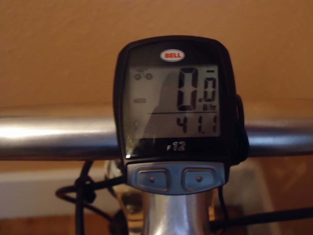

another note: I got my bike up to 41.1mph today still in break-in (no hill, no wind). I'll post a speedometer picture in the morning for all the non-believers out there...

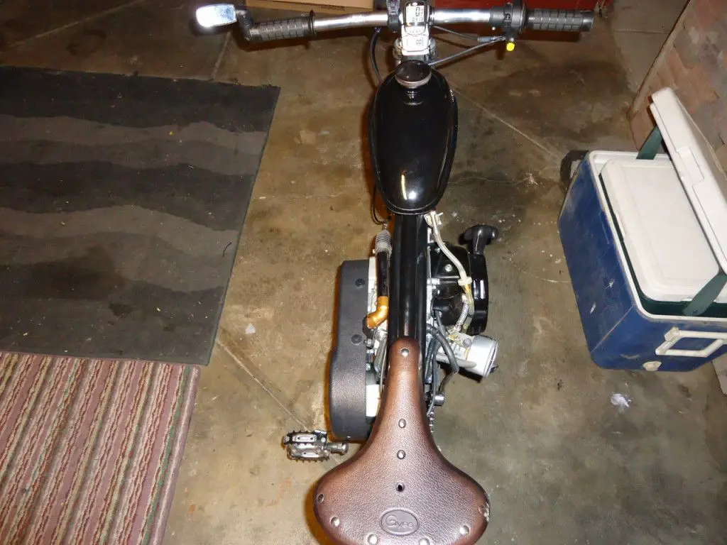

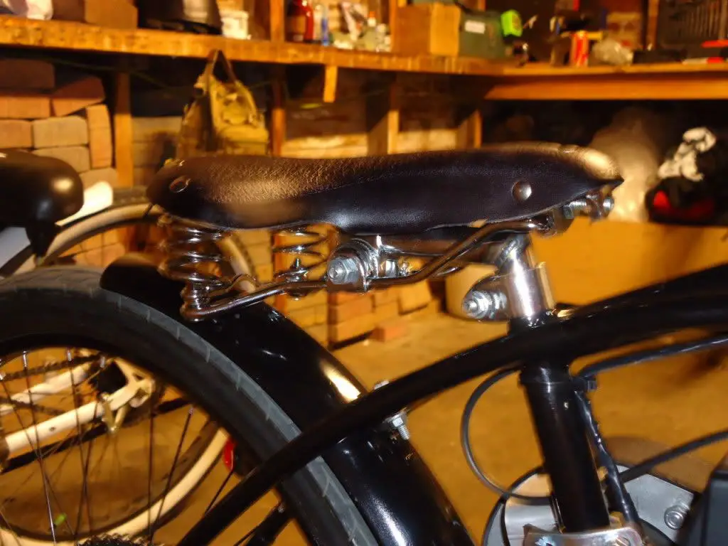

I finally replaced my saddle...
The seat that I have been using for over a year just wasn't right for this bike. Although the old seat looked like a leather saddle, it was just a pretty much a mountain bike seat... hard and narrow. After about 30 miles my back would get uncomfortable and so did my butt.
I finally bought a real leather saddle and this thing is amazing! Even right out of the box it is much more comfortable then any other saddle I have ever used. I got some leather treatment so this thing breaks in perfect and stays looking good. We rode about 60 miles on Saturday and I felt great no discomfort after riding what-so-ever. I highly recommend putting one on you list of mods if you don't already have one. (^)
2door
Moderator
Staff member
Sep 15, 2008
16,302
175
Littleton, Colorado
Re: F_Rod's Winter Build
Looks good, Frank. In fact it looks like it was made for your bike. Much better than my banana idea.

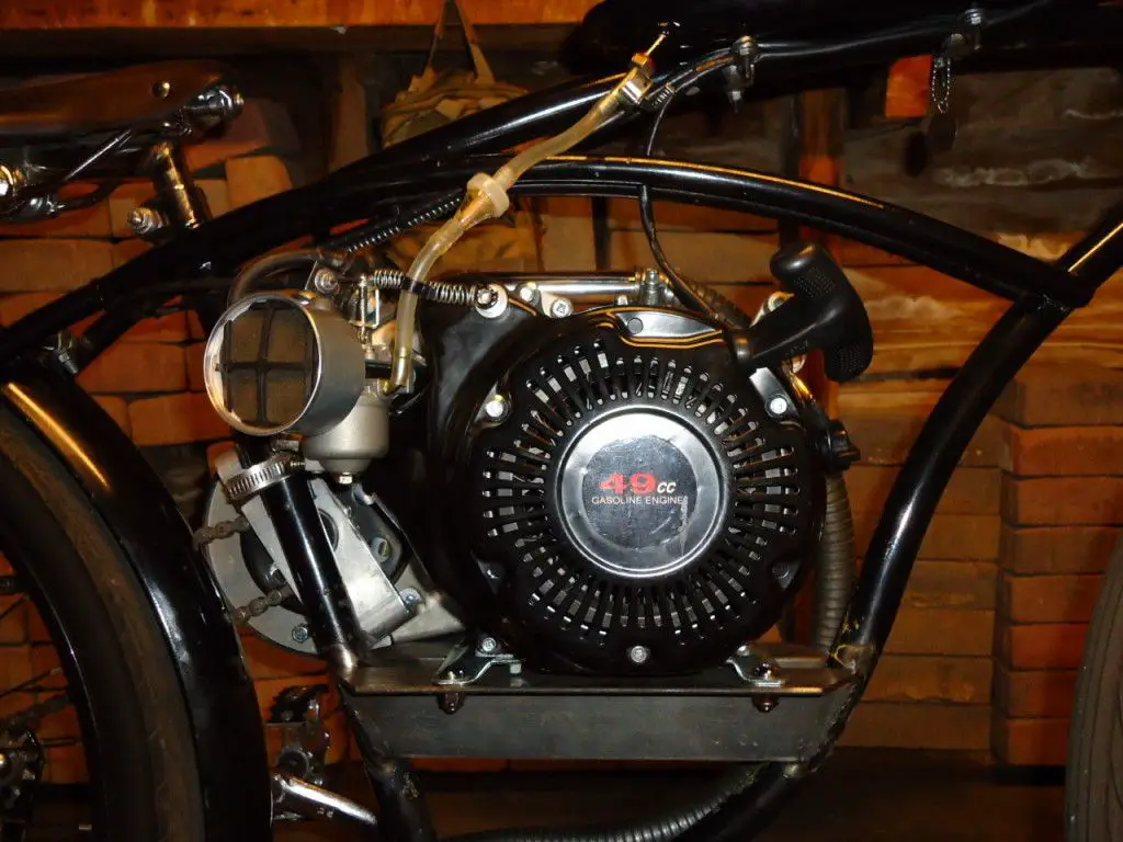

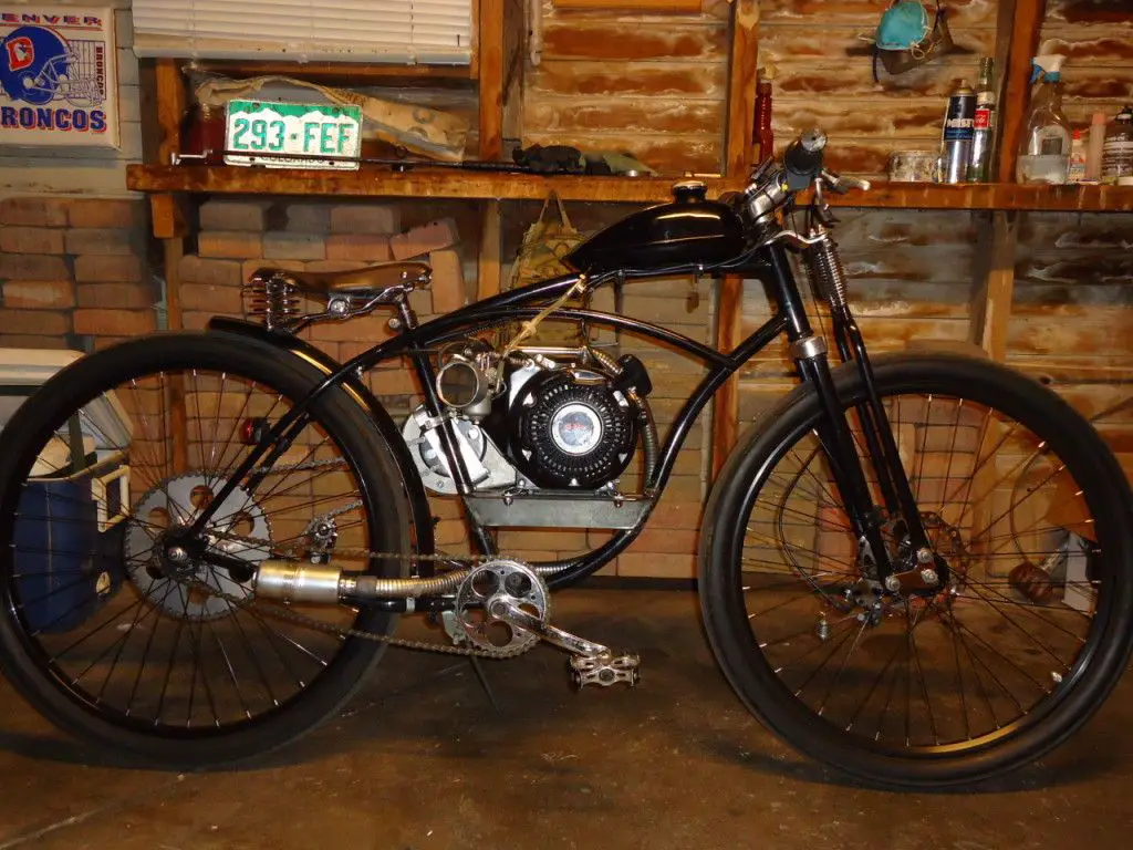

Well with all the predator talk going on these days I figured "what the heck"... here she is after the conversion! This motor is bad azz!!! Now I just need to fully break it in, dial in the tuning, and repaint.

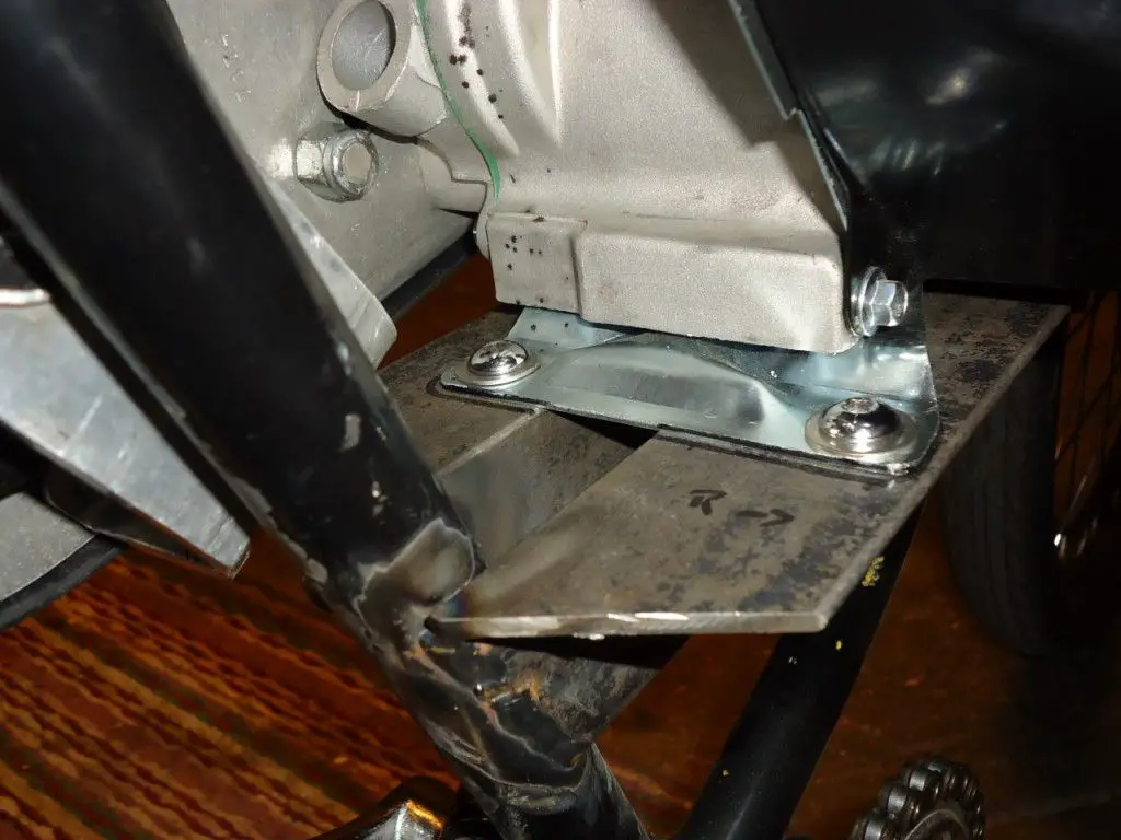

I couldn't get the kit clamps & agk mounting plate to my liking... the engine sat at a weird angle just didn't look right. I fabricated a mount out of 2'' angled steel and had it welded in place (perfectly level).
I thought of chain line before hand, so instead of trying to be spot on with the staggered bolt footprint this motor has, I used the mounting plate that the HF99 came with and made sure the chain line was as close to perfect as I could get it. When it was where I wanted I just clamped it in place with some vice-grips and marked my hole pattern, drilled and wah lah.

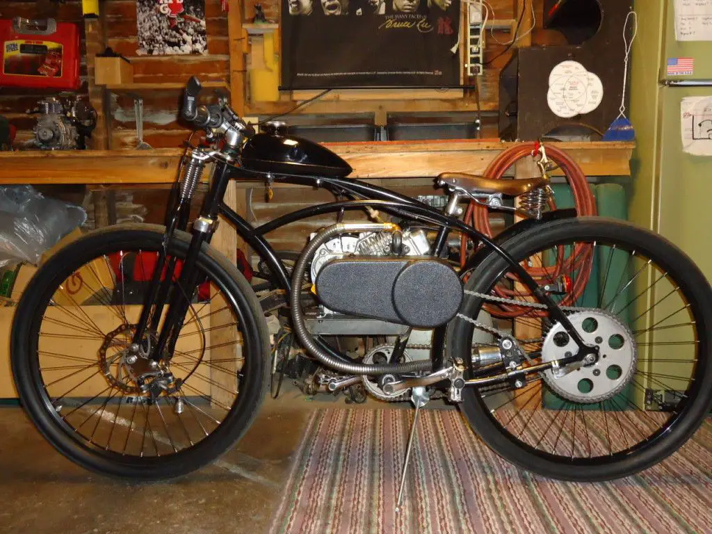

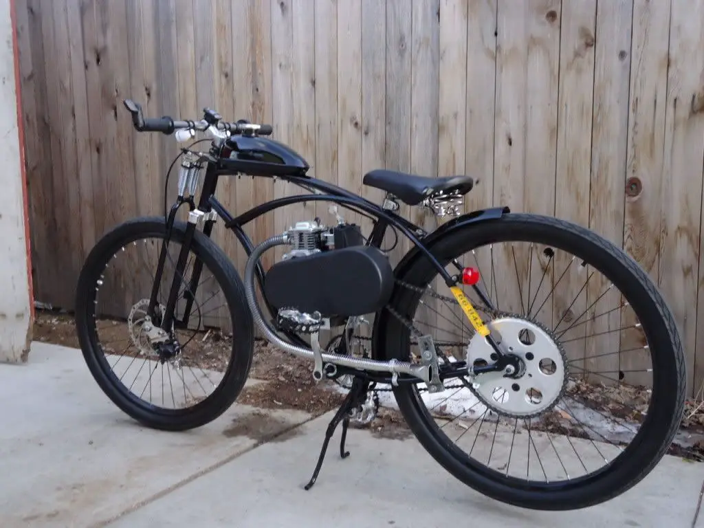

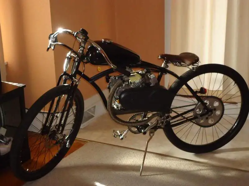

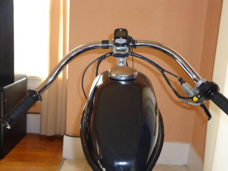

Okay here are a few updates that I should have posted about a month ago. I haven't been to active on the forum being busy with work and all. Anyway, I wanted more of a BTR feel and look to the bike; rather then a bobber or cruiser look that it has always had. I put on some inverted handlebars and cut them to the length I felt comfortable with. After the swap the bike rides a lot different, better, but different. The HF99 is a gas guzzler compared to the HS. So I ordered the Whizzer reproduction tank that is sold on eBay by LEB / BGF. Very nice tank, it fit well and looks much better then the stock peanut tank that I was previously using. Now I can have a little peace of mind knowing that I don't have to stop for gas as often.
