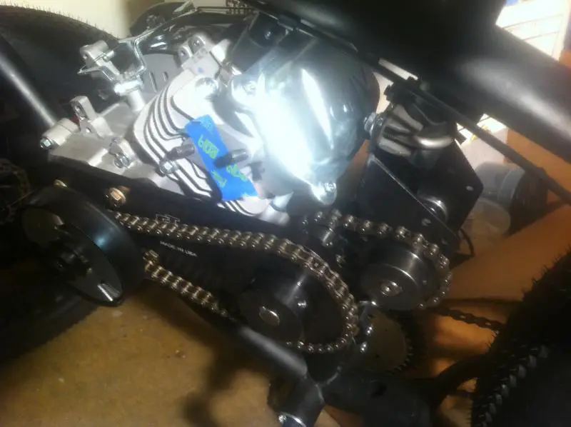

A CVT is a power vampire at the start of drive train, but none the less it works well.
I fashioned the mount with new parts I had in the shop.
I could only get like 40mph out of it, my 48-53cc 4-stokers get that.
At this point I may end up with tav2 Comet. 40mph is faster than I want my bike to go without LARGE disk breaks and down hill suspension fork. Maybe a better seat and wider tires to lessen vibration at that speed.
How is the gear ratio on the Q-Matic? We have some crazy steep hills around here. I can hit 33mph ~ 36mph just gliding.

7 speed manual Predator?
I wonder if the gears can be setup like a Q-Matic with a gear on output shaft and centrifugal clutch in back the get chain away from leg.
Someone did a 7 speed 79cc on the sick bike parts system. I am going to try and copy his work.
