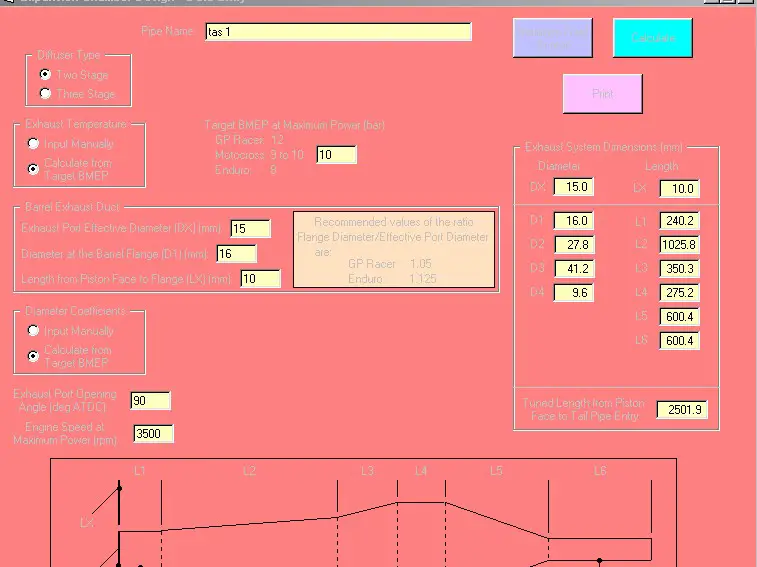

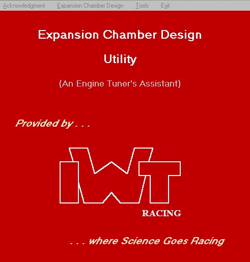

Well, I had some time while ago to unzip that Expansion Chamber Design Editor from the post above. pipe_dns.zip of 1.5Mb. It's straight foreward enough but I'm not sure about the horse power we're running with our projects. We may have to double the HP of our motors (or 10X) to enter so the software will accept it and at the other end divide the diameters and lengths by half or 10. So with all things being equal we may be able to get some workable figures it.
When you open it this is what it looks like:
The program is straight foreward and if you can use a caliper to take measurements on your engine and a piece of wire to feel into a port to a piston (and measure that distance with your caliper) you can probably use this software. The other values are probably in your owners manual or on a plate on the motor or housing. I would advise
trying to build the chamber as straight inline as possible so it can mount to the cylinder and toward the back on the frame running at an upward diagonal like dirt bike. It will be easier to build and mount and clear the pedals better. If you have a successful build, then a heat shield could be built of perferated sheet metal to cover the area where you inside leg would need a 1/2 inch barrier from the hot chamber.
This even lays out the profile for your expansion chamber for you at the bottom. Even sweeter is the Print button so you can print the chamber and spec's required to build it.
But since in Ahio we can only have 1 hp motors and this software wants HP values of 8 to 12+ I'll be "doubling and halfing" (or 10Xing) my math to walk the calcultions thru the editor. (then dividing by 1/10 the measurment it kicks out at the end.
