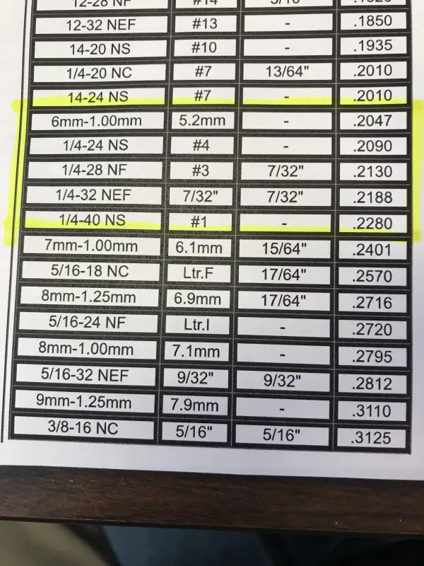

1/4 28 (fine thread) is the next size that is possible, aluminum needs fine threads. Use a bottom tap, it will thread all the way down as the name applies.
The chart below should help.

If you want to stay with metric 7mm would be next, Home Depot and Lowe’s have them in the specialty section.
