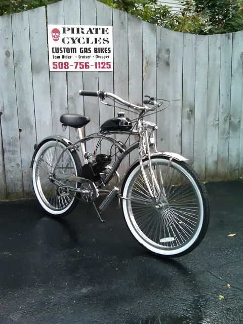

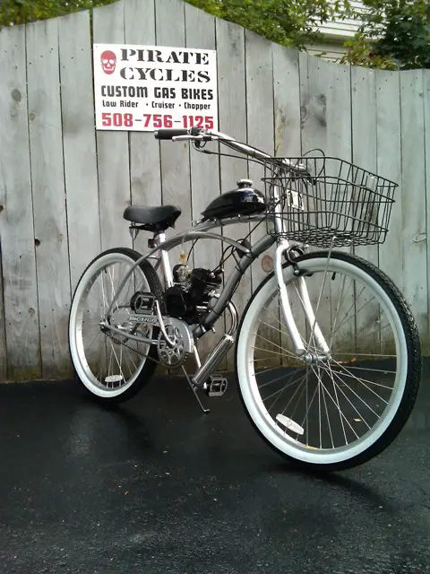

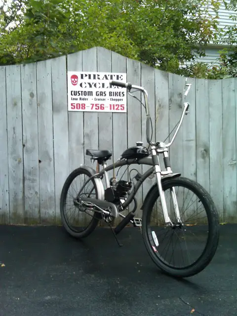

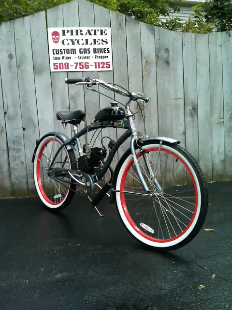

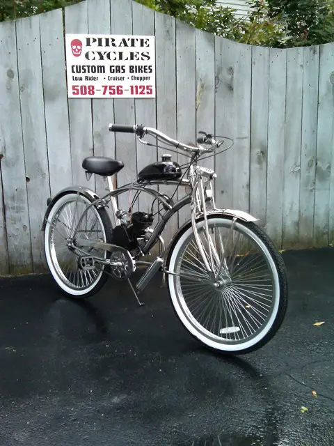

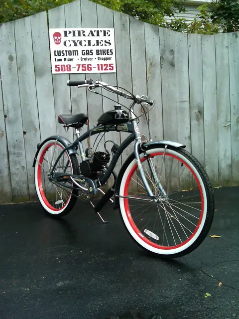

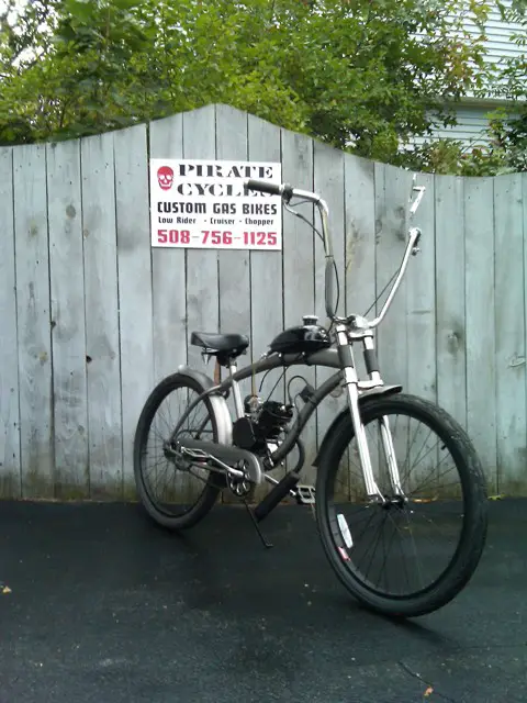

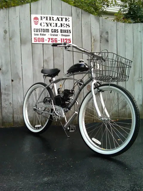

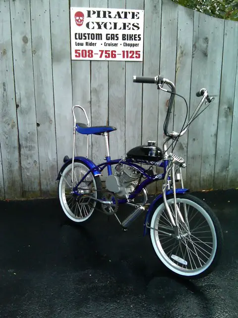

Venice,
Here are some pics of a few of our recent bikes with the motor directly connected to the bike. The kit comes with optional longer studs for the larger/longer down tubes. I double nutted and used the kit supplied rubber isolators while mounting the engine directly to the frame. I said they fit most cruisers, not all cruisers. Why is this a debate? I thought this was about sharing info with each other. I respect you and your builds and no disrespect to anyone else on this forum.
You want power claims you'll have too read around, or below. No dynos in the Budget this week.

Venice,
View attachment 17071 View attachment 17072
http://motorbicycling.com/f4/pk80-j-limited-edition-slant-head-13117.html
View attachment 17073 View attachment 17074View attachment 17075
