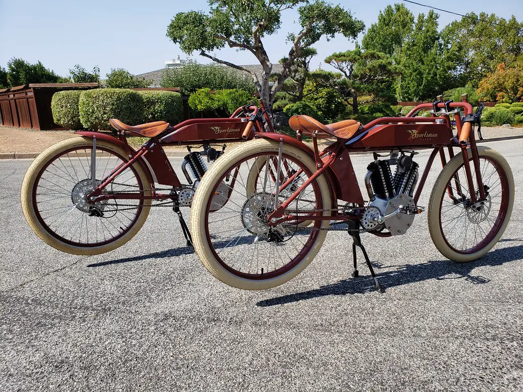

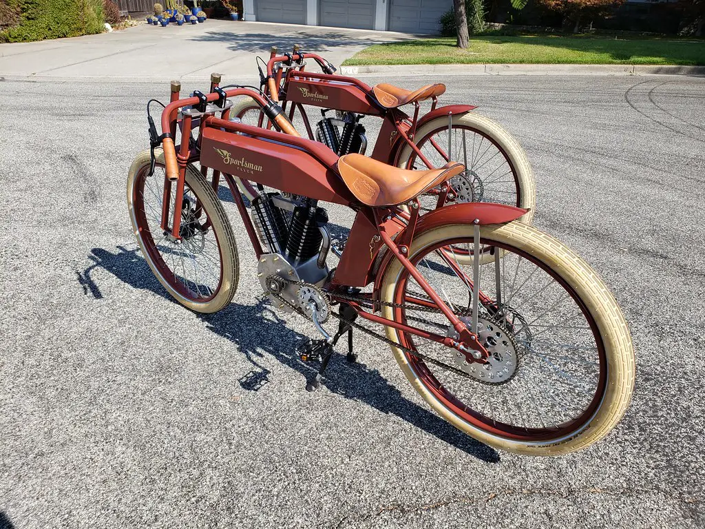

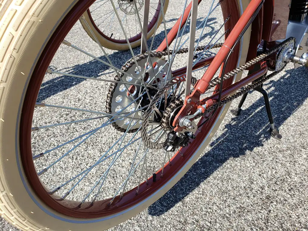

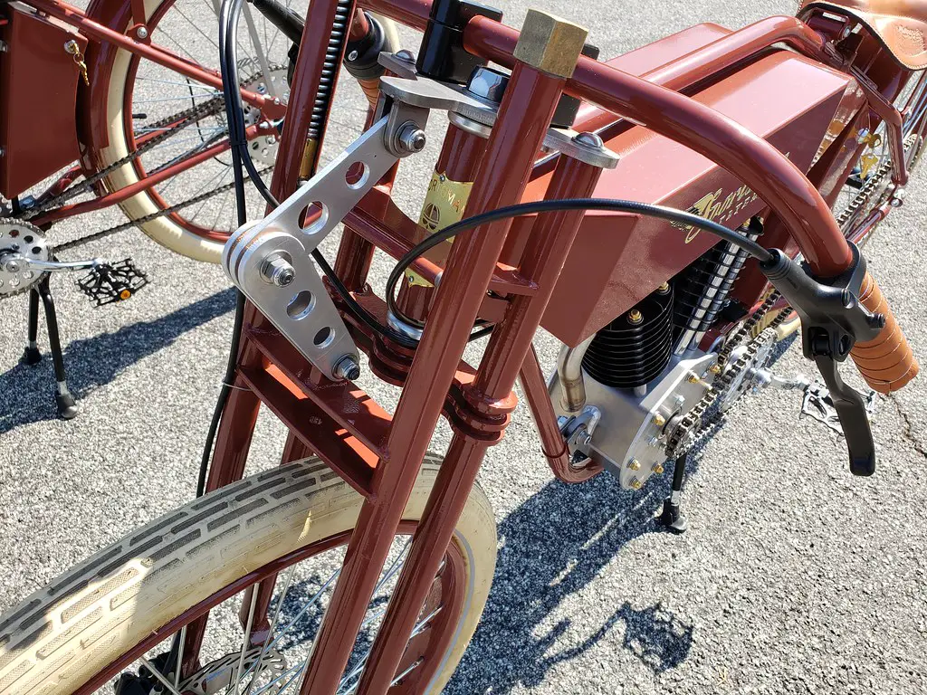

More electric bikes! These are two identical machines. Both feature 52v batteries, and all the standard Sportsman Flyer components. Harley style internal springer forks with adjustable friction shocks, disc brakes, mid drive electric motors carried in the v-twin cases, pedal crank reduction drive system, and Sportsman saddles. As before the 52v batteries are carried in the "gas tanks" which have removable bottoms, and the controllers are mounted in the tool boxes. Haven't measured max speed, yet, but typically a 52v Flyer maxes out with this gearing at 42 mph and cruises comfortably at 30 mph.

My o My! Hello Pat! I haven't been around much lately, but hope to be getting back in the mix a bit more. I have followed you since the beginning and you have never ceased to impress with your creativity and ingenuity . Congrats on this one. Are these gonna be available to own?

Hi Dan,
Good to hear from you. Think I have built 17 electrics so far. I find them very enjoyable to ride. Plenty fast and they can be ridden anywhere. Bike paths, bike lanes, keeping up with traffic. Just a no hassle way to spend the day.

Great bikes Pat. Are these his & hers bikes, separate clients or inventory?
Rick C.
Hey Rick,
These are eventually going to be his and hers. Much simplified engine cases from what you do, but as we have discussed before they are an economical approach in some ways. I would expect some people to customize them with added features. Fun stuff, these electrics!
Pat
