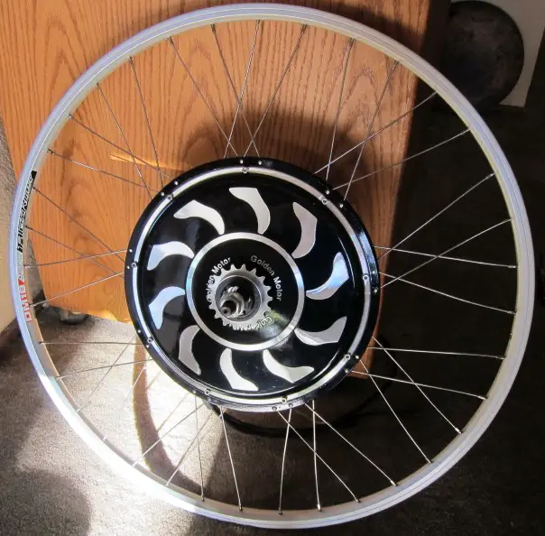

Bike shop laced up the old 28"er to 700C. Heavy duty double wall rim. And I bought the Sapim 14g SS spokes.
He crossed it too. I gots me a custom MP3 cross spoke wheel - :)
I also got a GM factory MP3 700C wheel in reserve. Just in case.

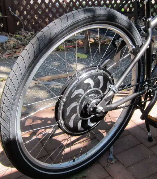

Went on really easy, didn't have to modify the slots at all. Did have to shove it pretty hard though, it is a nice tight fit. Love them disc brakes! The disc is actually better aligned with the Pie than the original wheel.
The drive side is cool too, but I have a little offset problem. Even using 2 spacer washers on the freewheel and 3mm chainring spacers. Ordered up some 5 mm spacers and that should get the offset down to 1.3mm. Close enough.
Pedals great! Not as good as before w/o the pie, but a lot better than the Revive. I think the MP3 has less drag than the MP2.

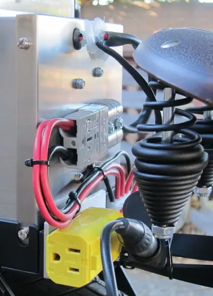

Details
On to the details.
Added a strut to the batt rack, batt is more stable now.
I just love this bike!
The details will probably take as long as all of this.
Details, details.

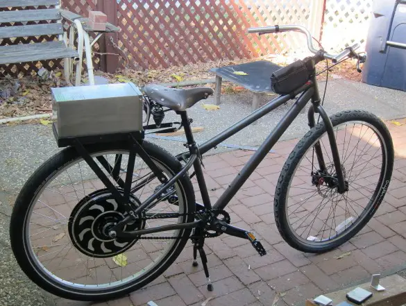

The big stainless steel box is a 48V, 20AH, Li-Fe-PO4 assembly from Golden Motor.
Worked on the details yesterday. Cut some metal, drilled some holes and now going to scrap it all.
A whole new plan came to me after I slept on it.

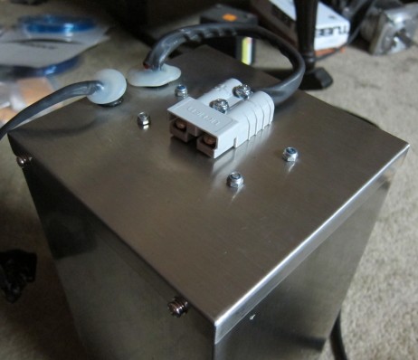

I'll give ya the before and after. I have already made some of the "before" parts too.
Before
Tie wrap batt connector to seat rails
Mount switch to batt rack
Mount terminal block to bike frame with bracket
After
Remove handle from batt box and screw batt connector to top of box.
Mount switch and terminal block to batt rack
Simple & elegant
Stupid me was trying to save removing the rack one more time. And mounting that big connector to the top of the battery where that handle is was sheer genius.
Sometimes it pays to work slow - :)

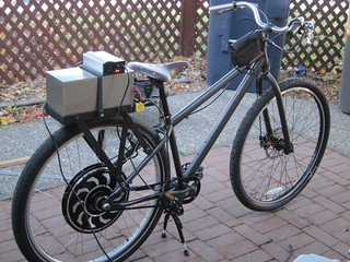

Got the power side done.
And went for the first ride! This thing flies - :) Don't know how fast it was going, but I'll take the GPS next time and we'll know for sure. I can tell you that I don't want to go any faster. Had to be 30 on the little downhill.
This is better than MP2. Better performance, less noise. Regen braking works the same.
Next I got the basket and lights to put on, a bracket to make for the control cable and other little bits like the speedo and stuff.
This has plenty of power for 29" wheels. I measured the big apple and it is about 29.25, so 29 even if you are on the bike.
