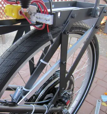

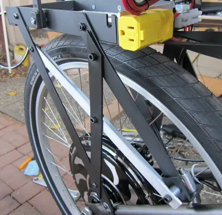

Added some angle

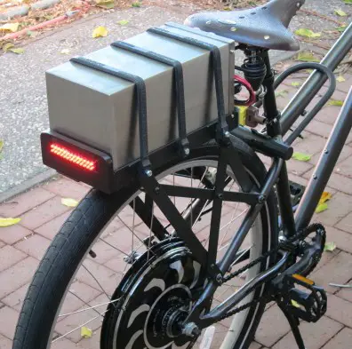

That big battery wieghs 25 lbs and I can feel the sway when riding, so I deceided to stiffen it up. Ran some angle across the struts and secured to the welded brake posts.
It's a lot stiffer now - :)
Also secured the control cable with another bit of angle.
Still need to do the basket, cruise control and lights.
That yellow AC receptacle you see is my key switch. It's wired in series from the battery to the controller. The "key" is just a plug with some 14g solid copper shorting it out.

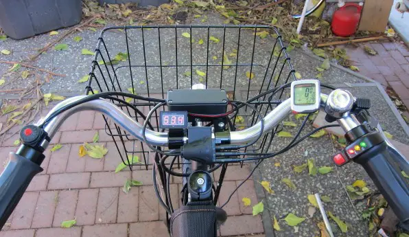

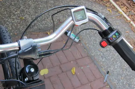

Need to wait for the headlight to come in before I can button this up. Going to do another junction box but I need to see how big the driver board is before I get the box. Am using another SBP switch for cruise control instead of the clunky factory switch.
The speedo is set perfect. Just entered the cm equivilent of 29 inches *pi and the max speed on the computer was 29.5. Max speed GPS was 29.3. Close enough.

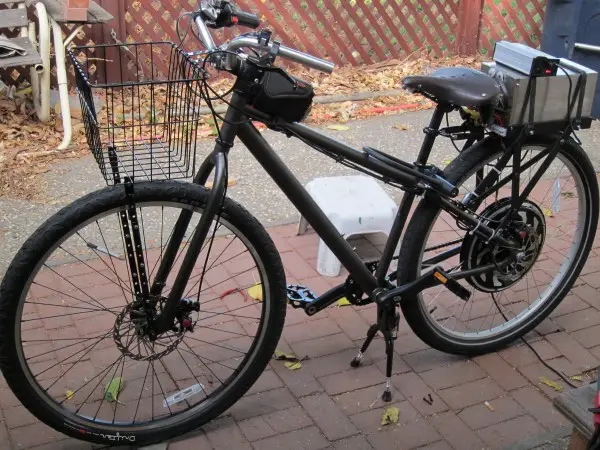

The stiffer batt rack solved all my sway problems. If I could just step through this frame it would be perfect.
Done!

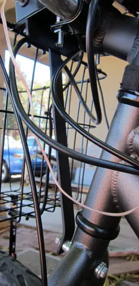

The first one was that ride I took with the 6 pack in the basket. The bouncing and the weight caused the basket to rotate on the top hinge. The nice thing about this basket is its ability to fit any bike well, but the hinged top bracket can move. Unless you stop it from moving.
Added a piece of angle under the basket brackets and a strut attached to the fork brake mount hole. Used the brake hardware with the nice dished washers to make it nice and rigid. That basket ain't gonna move if I load 30 pounds in it. Good thing too, 'cause that's where the headlight is mounted.

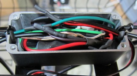

Did another custom, 26 red wide angle LED's in series on a perf-board potted with epoxy into a routed pocket in oak. This required a 68 ohm resistor to keep current at 15 mA at 54 volts. Which is located in the junction box that also holds the constant current regulator for the headlight.
The nerve center. This little box is stuffed. Headlight regulator, fuse holder, connections for the SBP cruise control switch and voltmeter connection and headlight/taillight. And it all works great.
