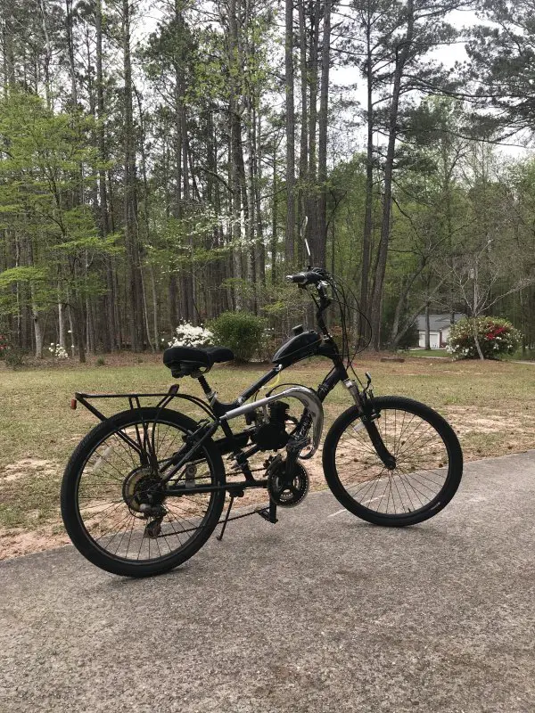

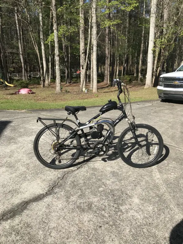

I’ve got it pretty much finished, I used a chain guard on this one because there’s a lot of chain exposed with the forward mounted engine. I have to make a rear mount for the chain guard, two black zip ties are holding it for the test ride.
I started planning motorizing this bike a few months ago, I finally got around to it. I made the rear mount to move the engine forward so I could use a expansion chamber, I didn’t like my first design so I redesigned it and made it a lot stronger.

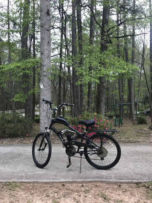

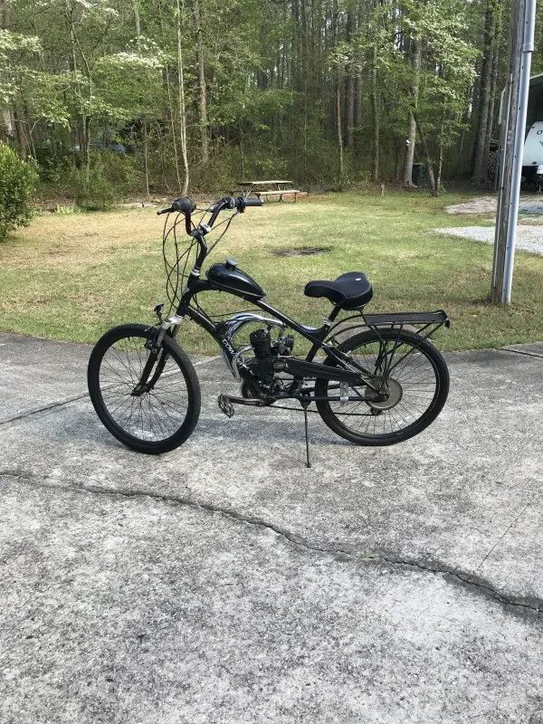

I have a 2018 Townie, what year is that one it's totally diff looking
It’s the cheapest one I could find on eBay, $30 shipped. I’ve got 3 and all three look about the same. I have one from CDHPOWER that is made and sized the same.
