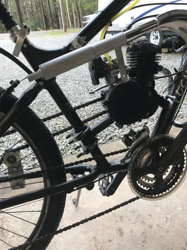

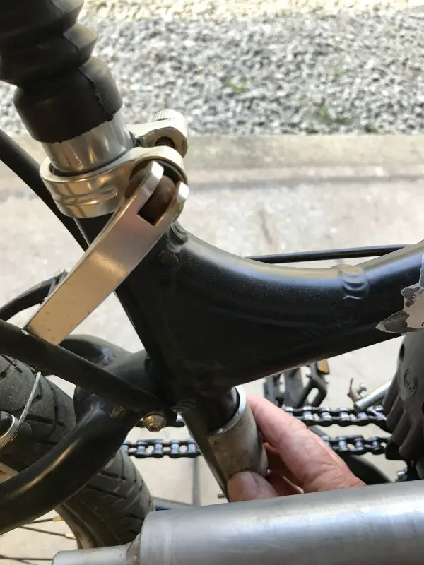

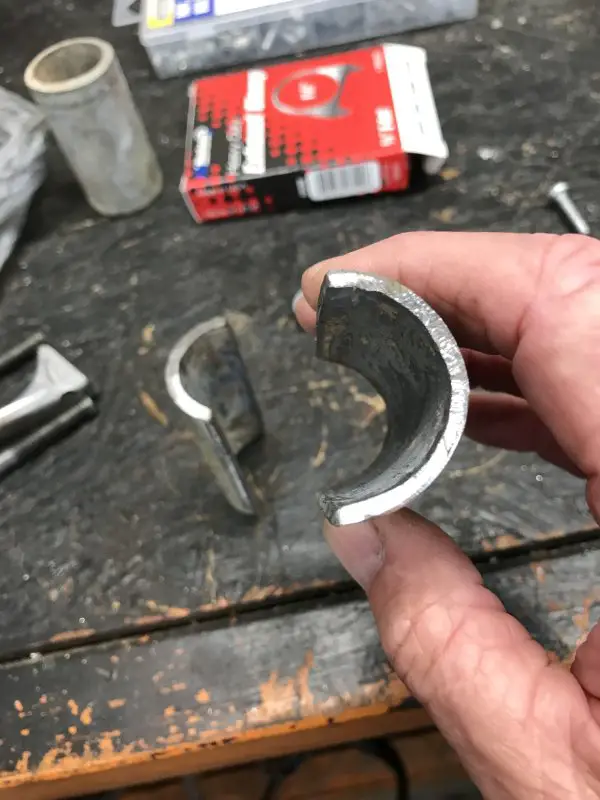

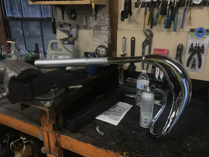

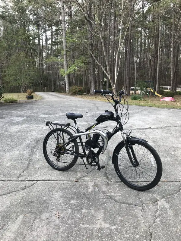

I started planning motorizing this bike a few months ago, I finally got around to it. I made the rear mount to move the engine forward so I could use a expansion chamber, I didn’t like my first design so I redesigned it and made it a lot stronger.

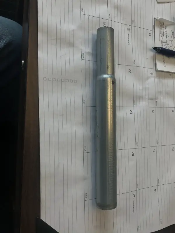

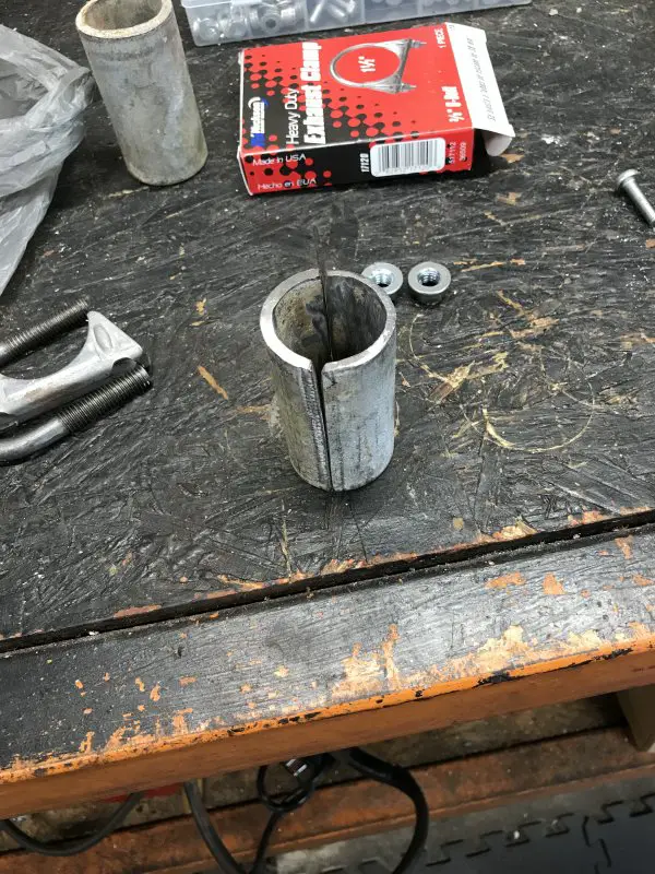

The silencer is a piece of chain link fence top rail, I have the rear mount welded to the silencer with a set screw to clamp the silencer to the pipe. This is the third silencer I’ve made for the expansion chambers on my bikes, the geometry is wrong on all of the pipe available, the outlet or stinger should not be the same size as the header pipe. The stinger on the silencer is around 60% of the header pipe, I got that information from Gordon Jennings and Graham Bell. All three of my bikes run great and sound good too.

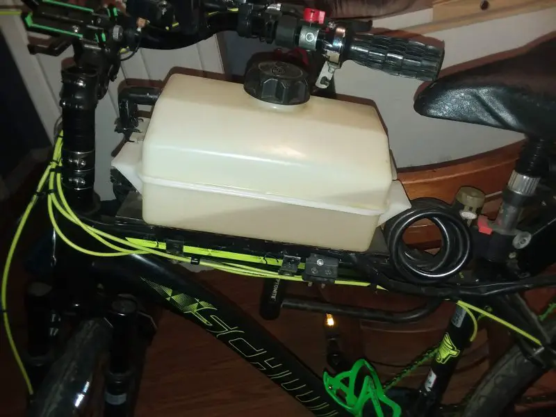

That is my oldest engine, it a GT2B Grubee made in September 2010, I pulled the cylinder before I put it on the bike and that cylinder is worn bad, the thing is it runs so good. This is the engine I had on the 24” tire bike, I’m way too tall for that bike, I felt like a spider on it , all legs.
