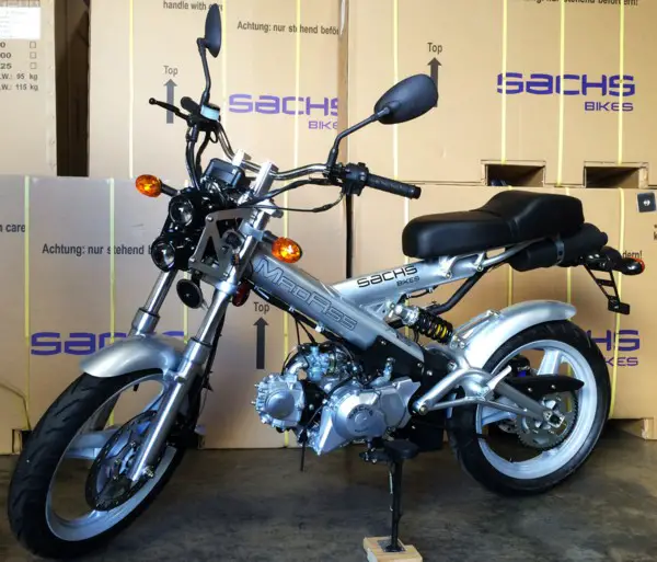

So I needed me a MadAss and this one's on it's way;

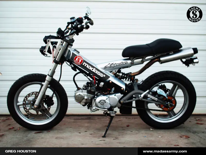

I always thought these were cool, the ultimate "naked bike"
It ain't naked till you ditch those fenders!
Might wanna down-size those mirrors too.....so they don't slap you in the face....
The advice from a motorcycle journalist and part time racer I know who tested one, the bike is mostly ok but if you intend going mental on it, get a better rear shock.
As for "ditching fender", remember the front one has an auxiliary important function. It braces the fork legs together and stops unwanted flexing. Better yet, if the bike follows the modern fashion of a spring in one leg and the damper in the other, they definitely benefit from being connected at the top as well as the bottom.

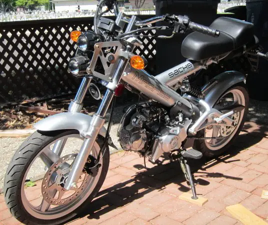

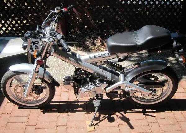

It's here!
Pretty cool eh?
Notice it has no shifter? 2 speed auto tranny. Really cool. Why? Perfect for Motoped.
I gots me a little trash to dispose of too.
If it's 2 speed mechanical change, when it starts to want to change up, ease the throttle a bit and it slips into top easer. Then nail it again.
I managed to uncrate/box it with no pain. Back is much better. I was ouching up a storm on Tuesday. It fired right up and I put a couple of miles on it around the "hood"
It has a rev limiter on it that holds it to 45 KmPH. Motor has a lot more room.
It should be easy to defeat the limiter and put a big bore kit on it which would really be perfect for the Motoped. The MadAss is getting the 150cc Piranha which should make it fast like the wind.
Looks like its got some good brakes! This looks much better than the little 'step through' mopeds you see whizzing around here IMO.
