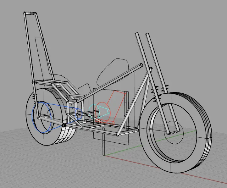

Here's what I've got for the frame design so far. I'm going to build it back to front, and deal with the rake and forks when I get to them. For now I'm thinking of it as a street bike, and then will stretch the front forks after I finish the rest of the frame.
Some numbers
starting wheelbase is 65"
skid plate clearance is 11"
rear wheel 24.5" diameter
front wheel 27" diameter
still not sure about what gear ratios I'm going for

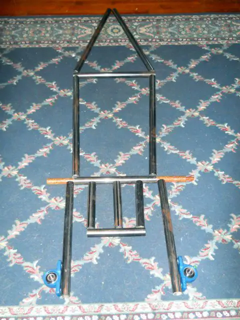

Finished sketching out the frame design:
I got 1/8" thick 1" ID black iron pipe for my frame. Cut the first few lengths this morning. Going to weld the front triangle and the wheel arch first and then connect them, I think.

Rolling chassis
Man, there was a lot between the last post and this one, but now the frame has both wheels on. Tons of work left, but I'm headed back to school and this rig is headed onto the back burner.

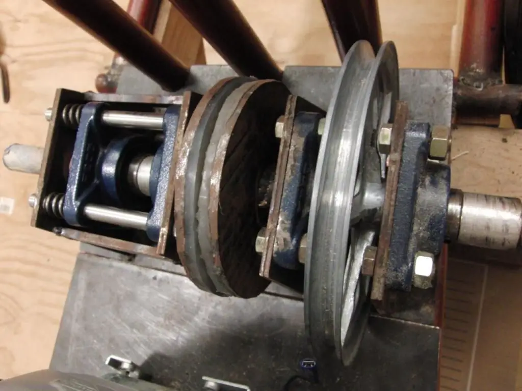

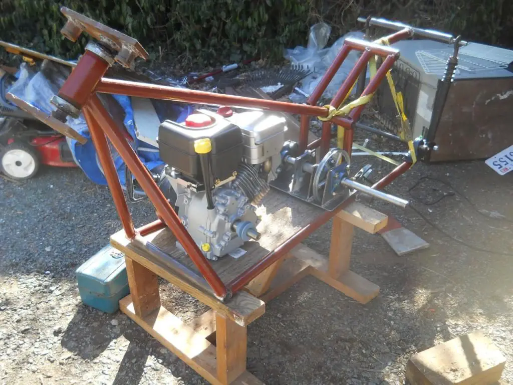

I haven't done anything in the last six months or so except think and draw plans, but I did a little welding stuff last fall/spring. I built the transmission, with a pulley from the engine to a spring-based clutch, to a 428 (I think, I'd have to look it up) motorcycle chain drive sprocket.
In that picture I'm still welding it together, but there are two clutch plates that mesh in between the two pairs of flange bearings, and the drive side flange bearings ride on a set of 1/2" stainless steel rails to allow back and forth clutch action. And then of course I also cut the extra length off of the jackshaft. As it stands, all the parts are there but I haven't permanently attached stuff in case my plans change.
I made a nifty stand out of 2x4s so that it won't rest on the wheels (or tip over) when I'm working on it. Here you can also see the very ugly but also very rust-proof paint I put on it last summer.

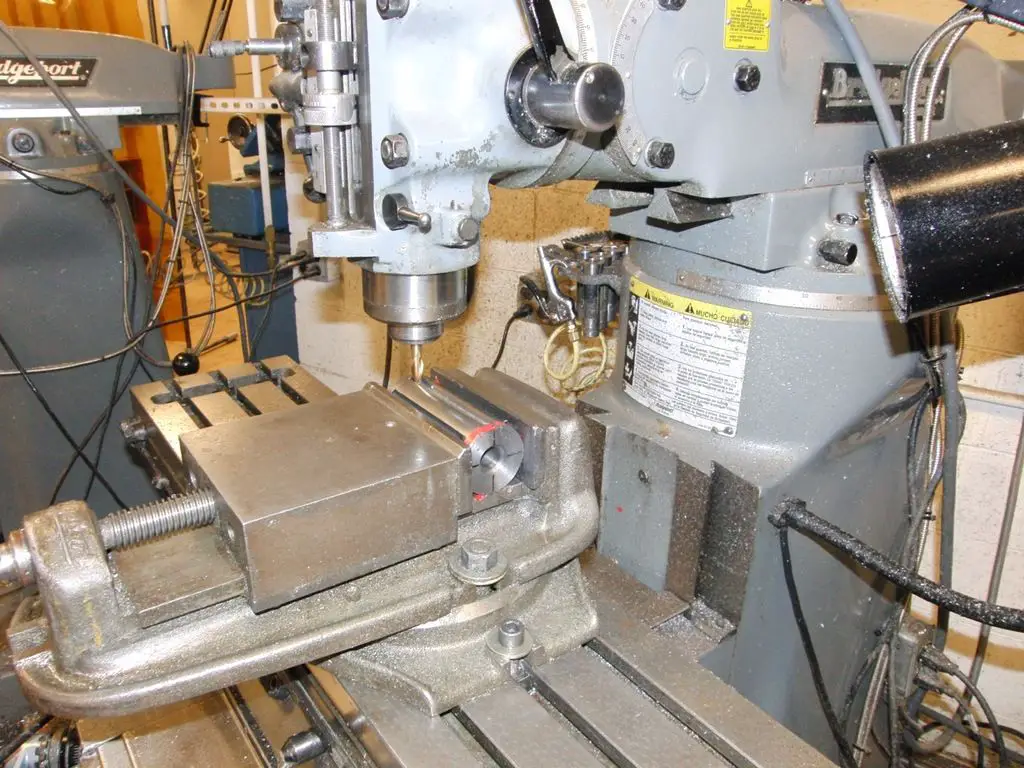

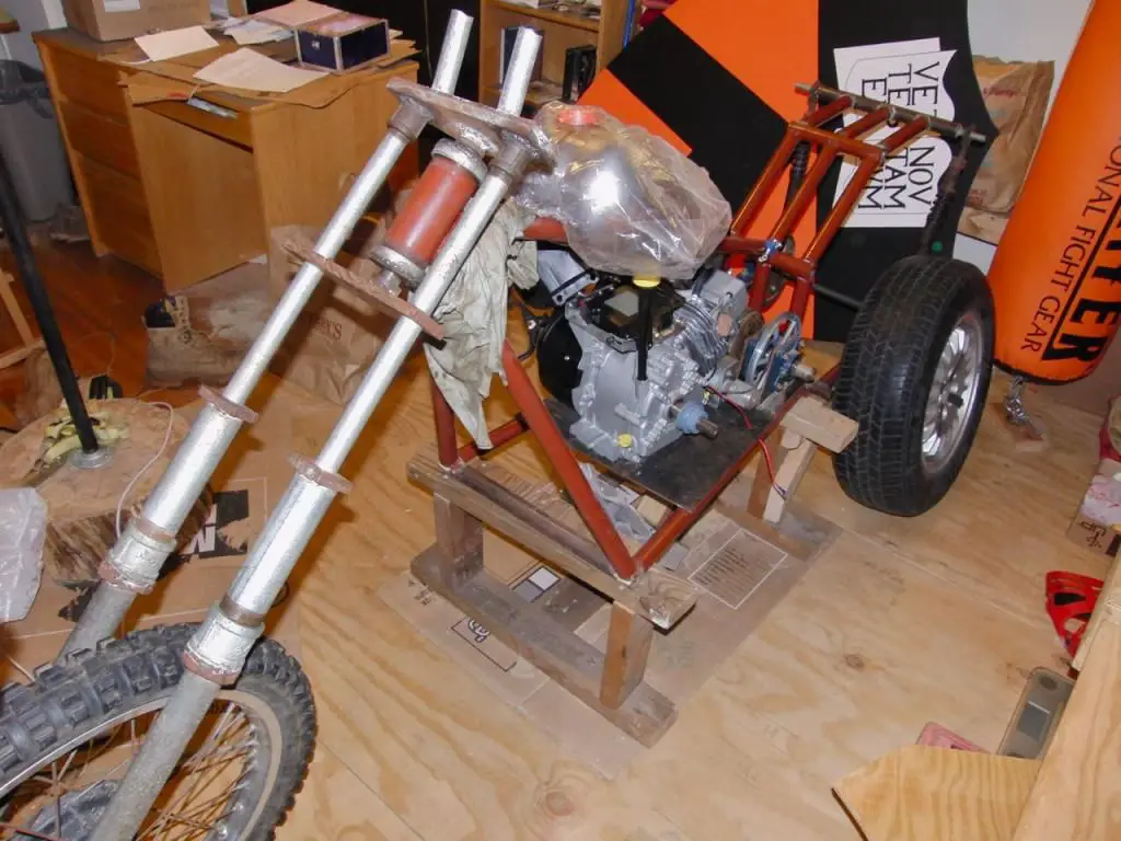

Here are some pictures of the Bridgeport churning away at the steel plate:
And here is the bike set up in my dorm room:
I wanted to take a picture to show the transmission the way it looks now, and I realized that there were a few other new-ish things. Mostly that I have a gas tank now (but I learned the hard way never to buy an unpainted gas tank very far ahead of installation, because I haven't painted it and it's rusted a little). The gas tank is a Paughco 2.2 gallon— closest I could get to a teardrop tank.

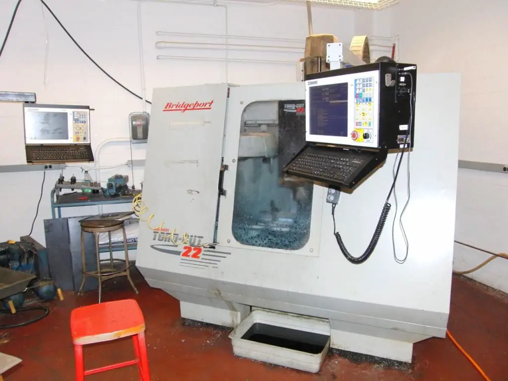

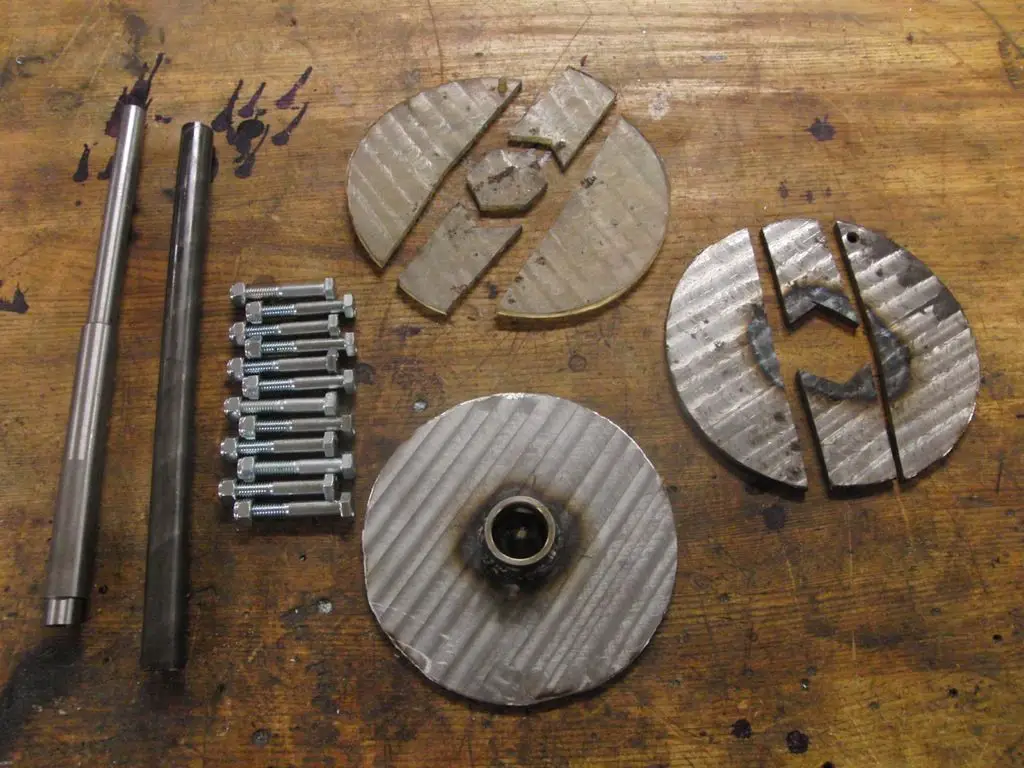

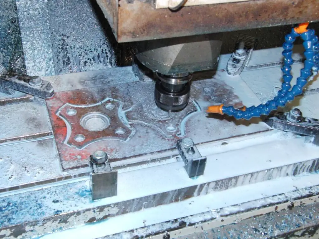

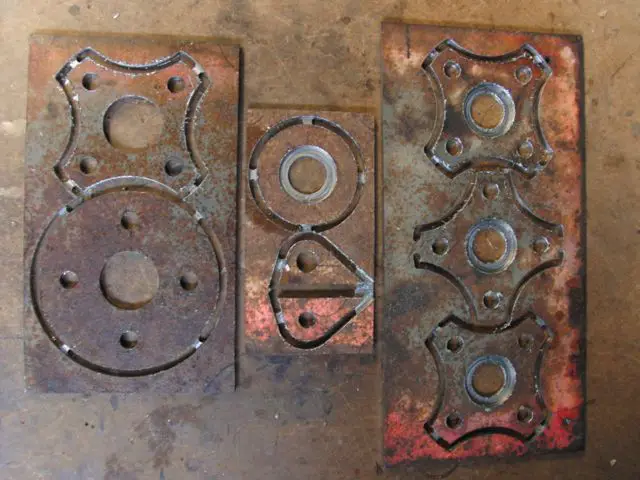

Ran the last CNC program on the Bridgeport today. So, ready to put the hub together. Here are the pile of hub plates, still stuck in the steel plate stock (the new lips for the front axle are there too):

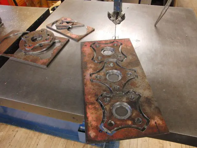

Then cut out the hub plates from the stock with the shop bandsaw.

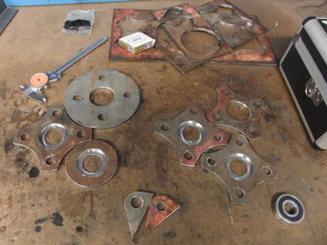

Used an angle grinder, dremel tool, and the shop belt sander to deburr the plates and remove the milling tabs. Lower amount of burrs on the last program compared to the first two sure showed the difference between using a HSS and carbide end mill.
Unfortunately, the mill cut the holes for the 2" OD bearings 0.01" too small (in other words, somebody didn't think about tolerances in the CAD). So, that expensive dremel tool sure proved its worth. Took two hours or so of sitting in the shop and buzzing away, but got the bearings to fit without totally ruining the center tolerances of the part. Looks fantastic too, considering it was by hand.
Called it a day, cleaned up the bench, put my shop clothes back in my locker, and took the finished plates back to my dorm... where I figured out that the 9/16 holes were milled under spec too, which should have been obvious had I stopped to think about it. So the bolts won't fit. A few more hours with the now-treasured dremel tool are gonna fix that, TOMORROW.

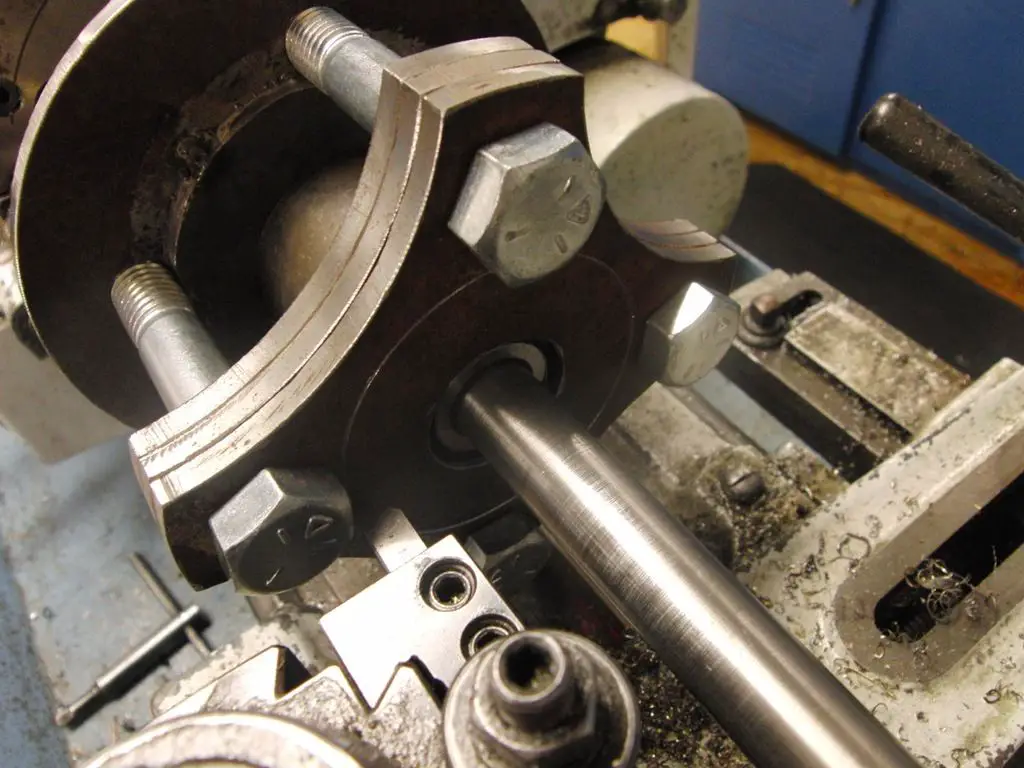

Progress. Put the back wheel on the bike yesterday (had to spend a while messing with bearing tolerances: precision bearings were 0.003" under 3/4", so did some gentle sanding of the axle on the lathe). But now the back wheel is on the frame, and spins for about five minutes. Actually haven't timed it, but think that's about right.

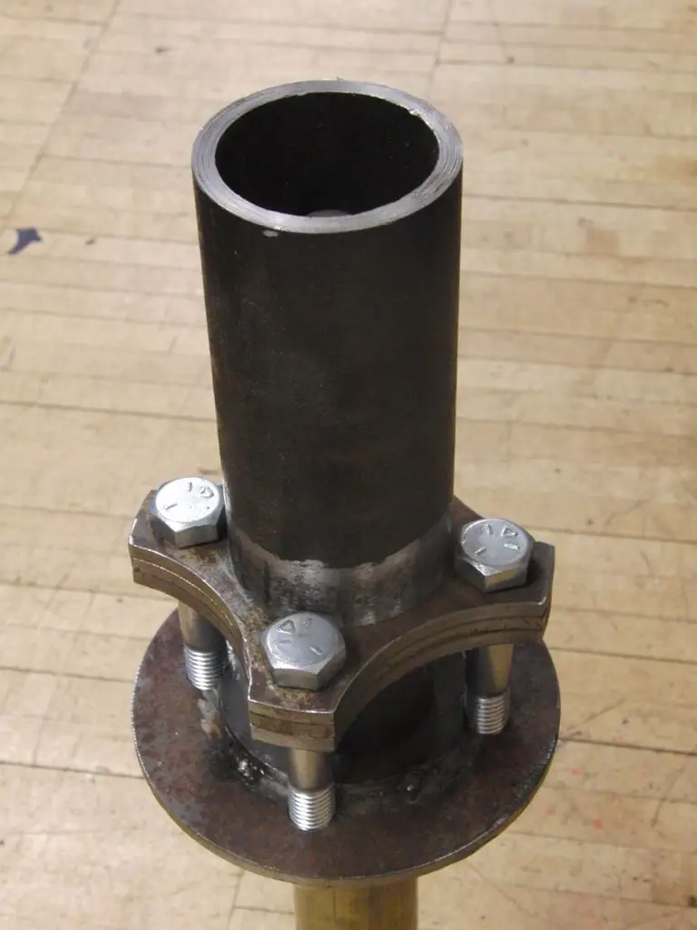

I didn't post about it in February, but here's picture of machining the overrunning clutch for the freewheel on the Bridgeport manual three axis mill. There's way more steel in there than is really necessary, but that's that.
It's only partway done in the picture, but I finished it back in February. We'll see if it works— if it doesn't, I'm just gonna weld it solid and not have a freewheel. I'm going to try to get the front wheel on tomorrow. That will make it much easier to get the rig back and forth from my dorm to the machine shop, because I'm really not supposed to weld in here!
Still far from done; just to get the freewheel together I've got to lathe some spacers and then weld the housing pipe to the hub, cut the rollers from rod stock, make sure everything lines up and then weld it all together.

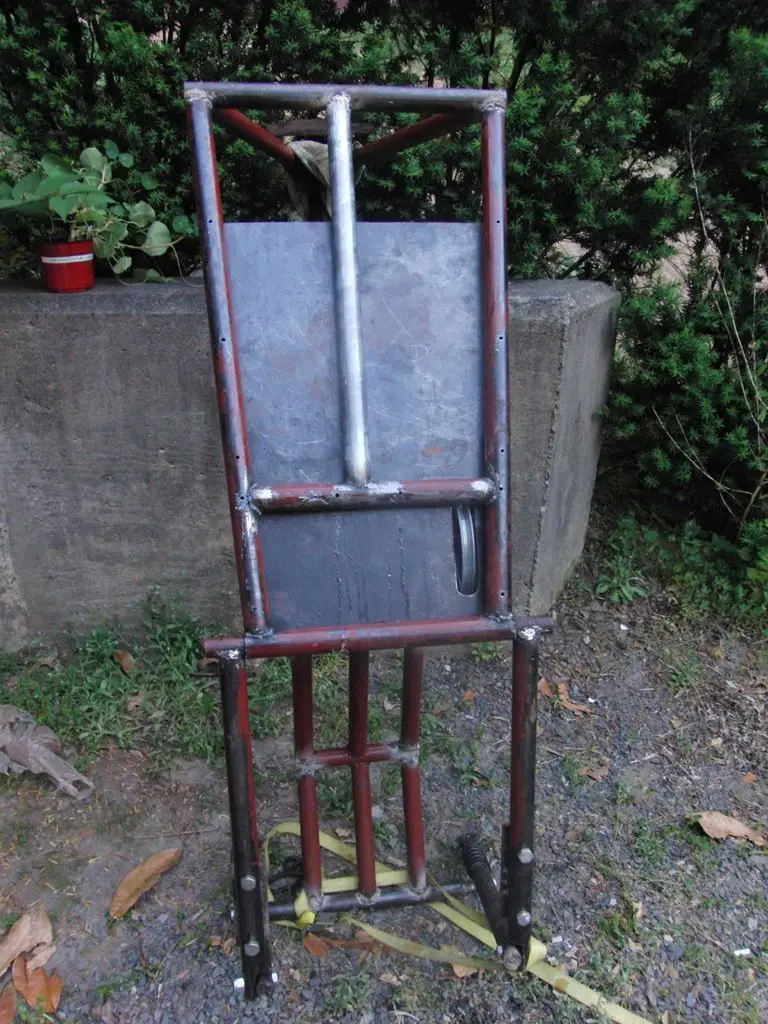

Over the weekend, packed up most of my dorm room stuff and moved the bike from my dorm to my new Batcave in the basement of the engineering wing. On Monday, welded in two new tubes to the frame to support the skidplates for the engine and transmission (not really necessary structurally, I think, but felt like they should be there). Tack welded the skidplates to the frame and then started drilling boltholes for a more modular permanent setup.
With the skidplates and transmission on, the bike is a lot heavier than just the frame. It’s also much harder to lift ergonomically because I can’t step inside of it to center the weight, and can basically only reach down and lift with my lower back. *Cue old-man grimace.* I can’t wait to get wheels on permanently so I never have to lift the damn thing again.

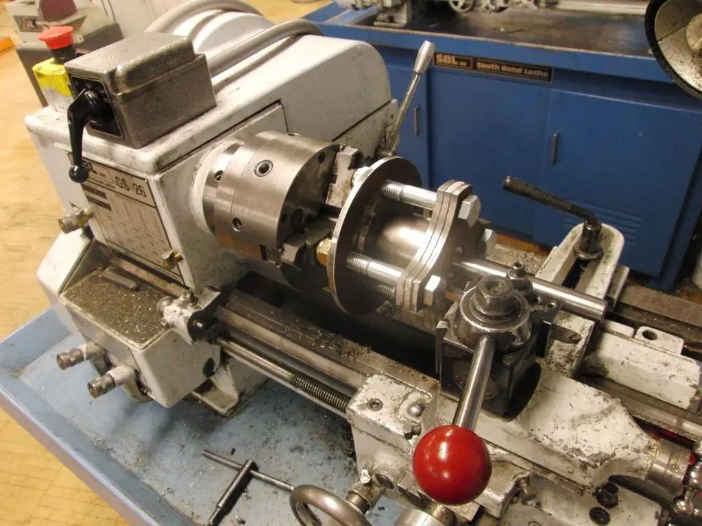

Today the machine shop was open again, so spent the shop hours on the lathe and Bridgeport manual mill, going back over a few things that needed changes. Lathed down the front axle a few thousandths because it wouldn’t fit through the hole on one side the lips, then made a new spacer tube for the front axle that has an ID with better tolerance. Picked up 5/16” bolts for the skidplates from the stockroom. Re-milled a new clutch plate because the old one was welded crooked, cut apart the old one and welded the new plate to the old collar. Fits on the old clutch axle and spins much more true now. Borrowed a 5/8” drill bit from the shop and drilled out the last two bolt holes in the rear wheel to fit the hub (my CAD from January didn’t perfectly match what BMW actually made). Then assembled the hub on the lathe with a short bit of pipe as a spacer where the wheel goes, in order to mark the circumference of the exterior tube of the roller ramp freewheel, so I know where to weld it tomorrow.
After shop hours, finished the second pass of drilling the skid plate bolt holes, but didn’t break the tack welds yet. Then assembled the rear wheel to mark where to weld the roller ramp to the axle. The wheel spins great on the bearings in the hub. A firm shove (by no means my hardest) sent it spinning for precisely four minutes and fifty-four seconds (my previous guess was pretty close!). Got a video of the wheel spinning!
