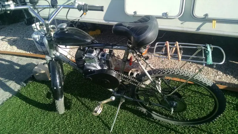

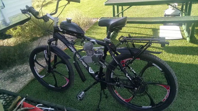

Hello everyone I have a chain sprocket problem, I have 2 bikes same prob on both. How do I check the alignment of the chain?
pictures soon

1.) read through this thread.
2.) Sight down the chain. Is it straight?
It should be or you'll have that.
3.) Thanks for the memories.

Sighting don't really cut it straight edge is the best touching both front and rear of sprockets, no gaps..........Curt
