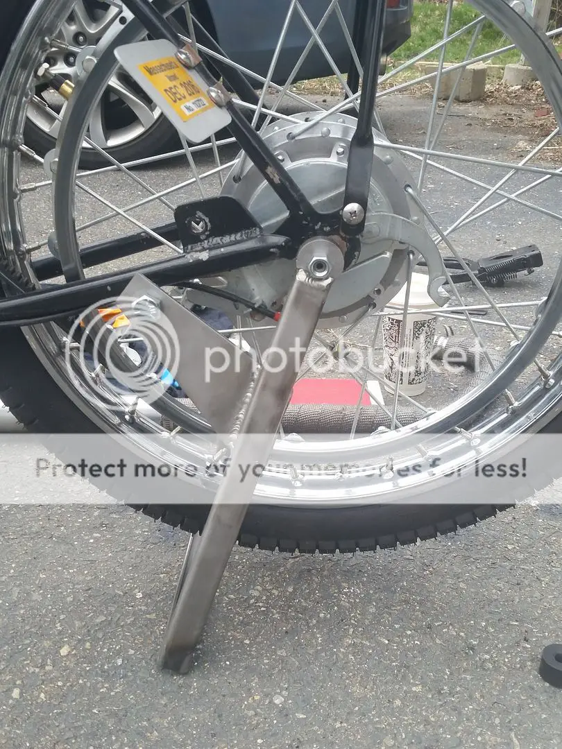

Here is a bad photo but it shows just how close these center stands are to scraping the ground. Yep this is fully up and looks like if I take it apart to modify it, I may never get it back together... or it will be super easy, but I will try this week.

Yeah Ziptie, ive already had a close call on a tight corner, I felt the stand drag then it kicked the back tire up just a bit. The bike had a quick jerk then straightened up. It ended up bending the stand just a bit. I guess if were a better built stand, that back tire would have kicked all the way out.
Sounds like a very close call! now for sure ...I'm going to alter mine Monday that's bolted on a gt2a with my angle grinder, so it will retract up all the way and then also hack the legs off so it lifts the bike just a 1/4 inch, reattactch those purdy rubber feet and it should be a safe kick stand. There are two notches that I just have to cut deeper after looking at it with glasses and good light.
