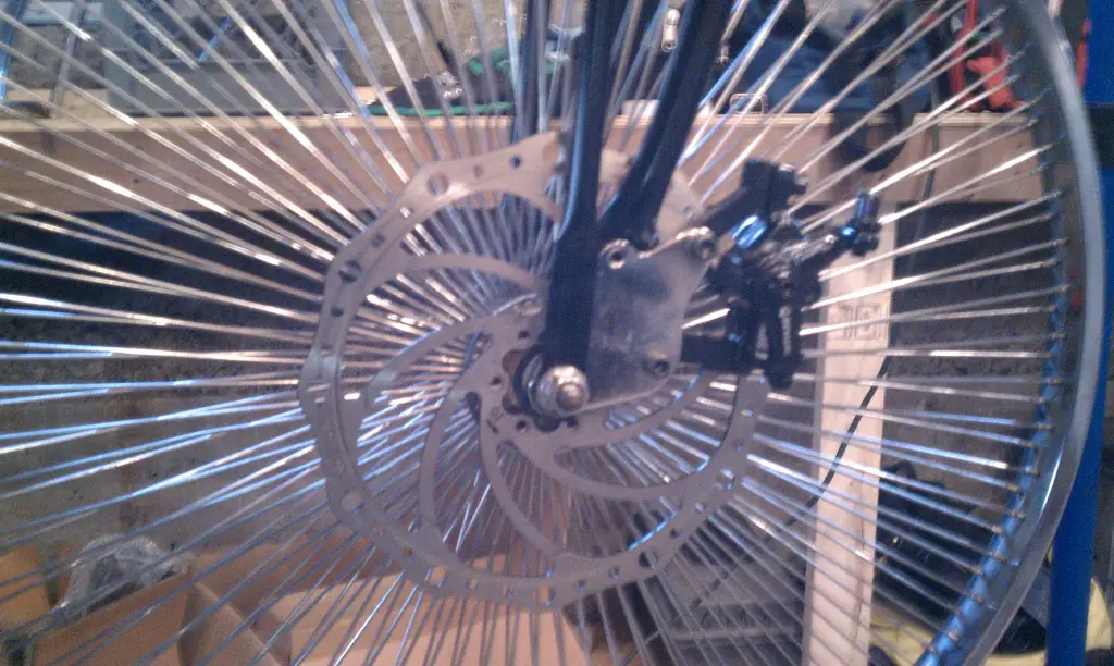

I'm doing the same thing with my front hub. I have micargi 68 spoke wheels with the manic sprocket and if the wheel holds up to the beating the engine puts on it im sure it will hold up to putting brakes on it. My problem is im having trouble finding a disc brake setup that will fit my triple tree fork.
CruisinOCMD
Jan 18, 2011
16
OCMD
here is my setup...We made our disc brake adapter out of 3/16ths stainless...the adapter that you buy bends very easy.
What caliper are you running? My fork already has tabs for the caliper so mounting isnt a problem but i purchased a tektro setup but the caliper is much too wide so it hits the wheel. I'm looking for a slimmer setup that wont hit the wheel.
Avid BB-7 might be a good bet for you. The calipers are small and thin. The BB-7 has pad adjustment knobs on both sides, the BB-5 has just one on the inside. Hope this helps.
Most bike shops will let you try a fit if you take your bike or front fork into them. Good luck.
