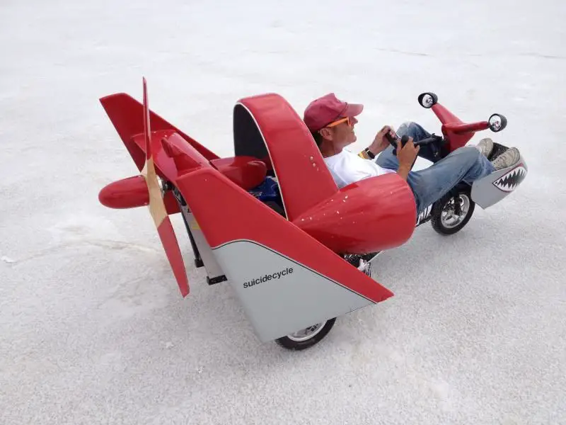

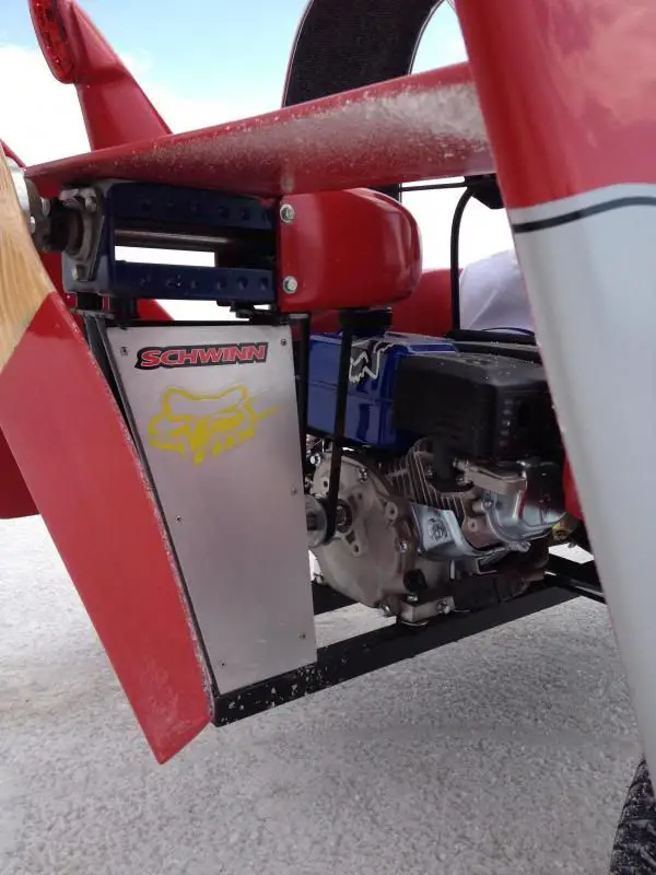

Saw this trike in Bonneville last year. A stock clone engine with a belt and pulley system powered the prop. He was just cruising the pit area with it. I was surprised how well it moved along.
With a prop the wind direction will make a difference in your ground speed. If you are going into the wind your ground speed will be slower. Go with the wind you will go faster.
And a prop will be less efficient than putting power to the wheel. You will also need the correct length and pitch prop for the horse power you are running. A prop is just like a transmission.
You have to be in the right gear or the engine wont turn it or it will spin it real fast but not move enough air to get any speed. But the cool factor would probably overcome all negatives....
