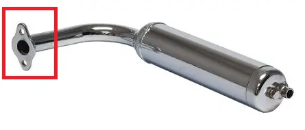

So, the original exhaust that comes with the kit was not able to clear my pedals. I peeked online at exhausts that could, I saw the viper exhaust that bends but didn't want to spend the money. I ordered the half moon exhaust and to my surprise, it works pretty well.
In the first photo of the exhaust, I circled the part I am discussing about in red. I am unsure what the name of this "end" is but if you could tell me I would appreciate it because it's driving me bananas.

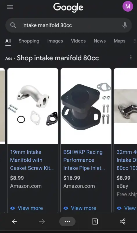

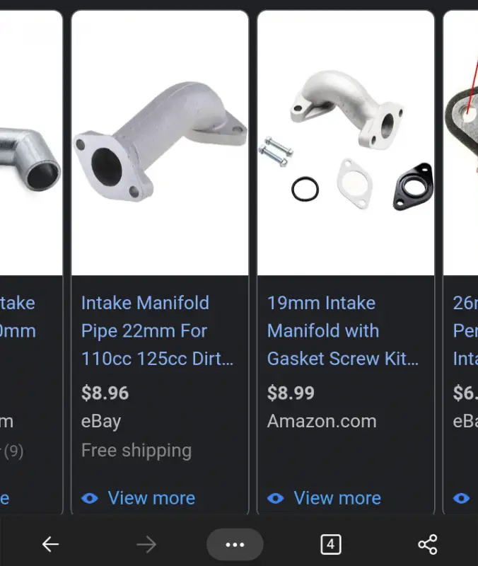

So, I was thinking about if it's possible to make an extension for the exhaust so that it would clear the pedals. It would be cheaper and you wouldn't have to do all that heating and bending. I did find online that intake manifold pipes have the same "ends" as the exhaust that comes with the kit.

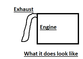

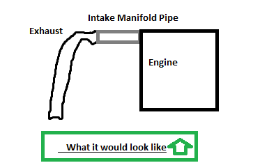

I made a diagram showing what it looks like when you just connect the exhaust to the engine. The second diagram shows what it would look like if you took an intake manifold pipe and bolted that to the engine, then bolt the other opening end to the exhaust.
They come in different sizes and shapes so it would come down to you finding one that works for your bike. I think this may be a cheaper way to go about making the exhaust work on your bike. I just need to confirm the dimensions I have with the kit exhaust to find an intake manifold that fits.

The part you have circled is the flange, the best way to get clearance is to heat and bend to fit, I’ve also drilled the mount hole slightly larger so I could swing the muffler away from the pedal.

I don't see why it wouldn't but it would add another gasket that could fail. I would also assume that it would shake loose easier without an extra anchor point. And finding the right angle without being able to fit them could be difficult. In my opinion it would be way less of a headache to just bend the exhaust or mod the holes.
So would this work or not? That's what I asked not for nothing.
I really don't think this will work well... the bolt patterns & flange sizes are totally different; & you're just going to end up having to spend more money to buy tools to modify the parts to fit. (& then if you do manage to get everything to bolt together, you're probably going to end up having constant exhaust leak problems. :(
