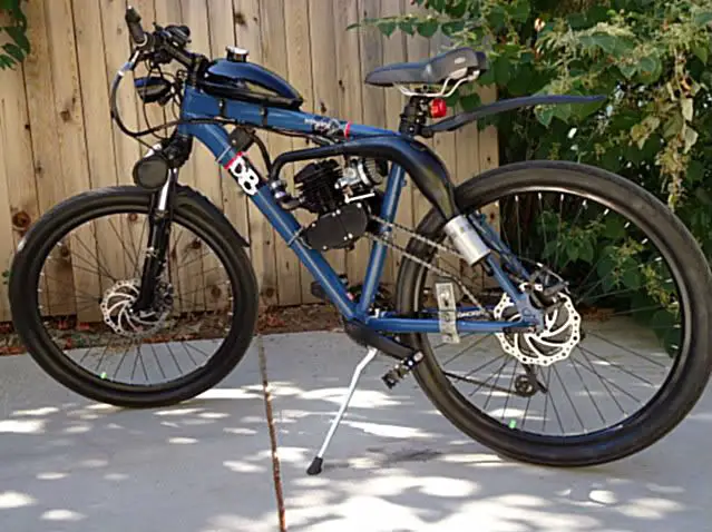

Dual 180mm Disc Brakes . . . no top hat adapter. . . no shift kit. Front has always been there, finally got around to the rear.
UNBELIEVABLE BRAKING POWER :)

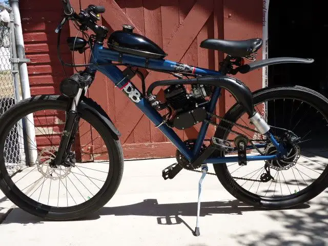

Here are the most recent updates to my MB. . .
Over the last week I have added the following parts, nothing major, just a few cosmetic changes!

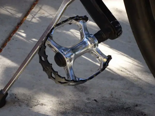

I added some BMX style "bear trap" pedals

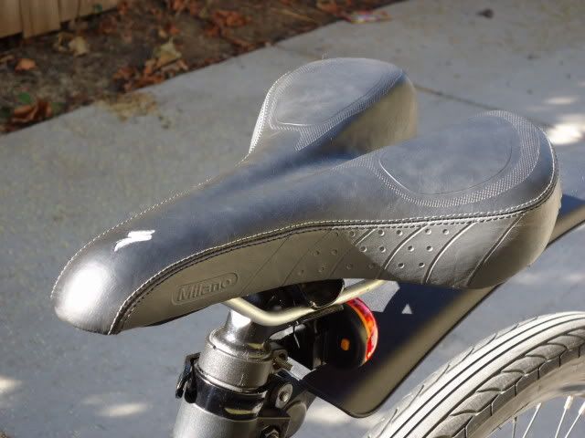

Then, my sprung cruiser seat needed to be put back on the cruiser, so I put on this Specialized Milano seat.

Complete list of mods :
- dual-disc brakes
- Kings 34T sprocket
- MM ported intake
- Dax RT carburetor
- SBP ex. chamber
- SBP plug wire/ NGK iridium plug
- fully port matched and polished
- H.P. Roller Wheel by Steampunk
- Lightened clutch plate/ pucks
- 12.9 grade metric hardware all around
- + all the cosmetic stuff
That looks amazing!!
Do you think you could take some pics of the rear disc/sprocket set-up? I have this exact bike in an 18" frame, and I always figured it would be impossible to get the rear end sorted out. So some details dealing with the back wheel would be enormously helpful.

I didn't take project progress pictures, just the finished product pics.
dual-disc-brakes
Nice bike, man!
I also got a Diamondback Response w/18" frame. I installed 203mm AVID BB7 discs front and rear. The large disc clears the frame by 1/8". I always worry about the slightest road object jamming the rear disc, so I'm replacing it with a smaller-diameter BB7 disc.
I agree with you that the brakes are awesome. The bike itself is a dependable and predictable performer.dance1
Nice bike, man!
Thanks,
I was considering 203's but I didn't like the clearance. 180mm or 185mm will work out for you fine; Depending on your setup. Your right about the bike being predictable. I like to call it a "little R6" with the square frame design it's kinda like the Delta box frame offered only on the Yamaha R6 and R1. This bike knows what I want to do before I do it. Very good bike for and all around build (speed/power, handling, braking)
