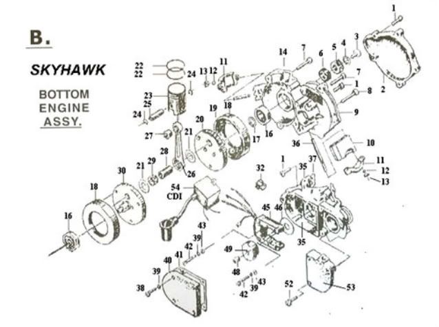

It would be nice if I had a diagram but they did not send one,
please tell me exactly where are you talking about here ?

Yes, the post at the end of the cable, (number 32 I think in the diagram) remove it and get some heavy oil down in there.
