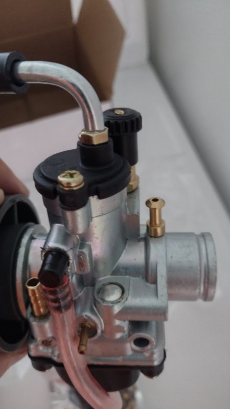

M Mossy Well-Known Member May 20, 2022 1,128 819 113 Aug 25, 2022 #1 I got this 19mm BS and thinking that the 1/16" nipple goes to the power jet but wanted to make sure? Attachments IMG_20220825_113617871_HDR.jpg 42.4 KB Views: 59
Venice Motor Bikes Custom Builder / Dealer/Los Angeles Mar 20, 2008 7,277 1,824 113 Los Angeles, CA. Aug 25, 2022 #2 That small nipple might be for a 2-cycle oil inlet?

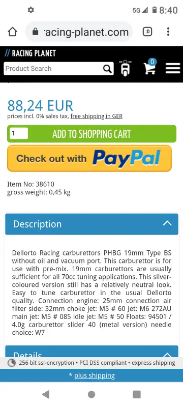

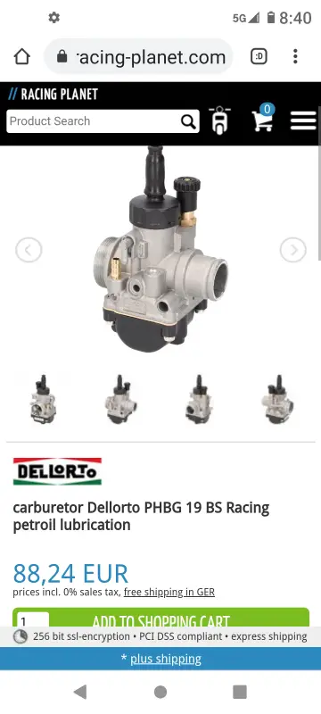

M Mossy Well-Known Member May 20, 2022 1,128 819 113 Aug 25, 2022 #3 Venice Motor Bikes said: That small nipple might be for a 2-cycle oil inlet? Click to expand... They would be the same size of it went to the jet... The tiny one is oil and the other is a vaccume port.... I'm going to get the one with out it and have it for parts... Attachments Screenshot_20220825-204015.png 107.7 KB Views: 51 Screenshot_20220825-204029.png 113.5 KB Views: 48
