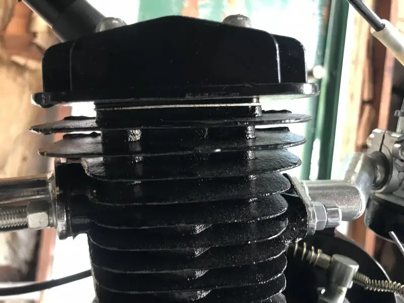

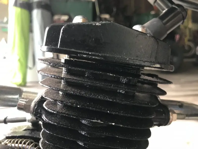

I've very new to motorized bikes. I have a kit I was going to install, but a pre-built bike fell into my lap. It's been running intermittently. Sometimes good, sometimes bad. So I looked at the cylinder head and there was a slight leak. I tightened up the head a bit, but it doesn't seem to be sitting strait against the top of the cylinder. I'm afraid of over tightening. It also seems as if the head isn't sitting flush. maybe it's warmed. That said, the engine hasn't even been run for a single tank. Its still in break in.
Not sure what I need to do, or exactly which make of engine this is. It's different then the one I have boxed up.
Since I already tried tightening the bolts, I decided to pull the plug and remove the cylinder head. BUT as soon as I removed the first cap head nut on the side of the leak, I realized the whole bolt was coming with it. I'm thinking this means I have to take it all apart, but am afraid to see if its threaded. Does that sound right?

It's hard to tell by the picture which engine you have, the cylinder fins look rounded like a gt2b Grubee, if the head nuts are 10mm socket (6mm thread) it's a 48cc, if the nuts are 12mm (8mm threads) it's at least a 66cc engine.

That gap you are seeing is perfectly normal!!! (in fact, when you over torqued it, i'm sure you warped the head & caused it to leak more)!!
When you take the head off, you'll see a small ring on the head surface that actually seals to the gasket.
Do as Curtisfox said & sand that ring on the head flat with some sand paper on some glass (or other flat surface)
Re-install the head (with a new gasket) & torque it to 12 ft/lbs
