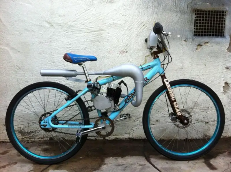

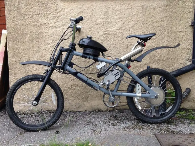

OK, knowing your requirements is good. Too much info is never a bad thing.
If a BMX frame and pedals are a must have for any motorizing project you have in mind, it can be done. Although yours may not be one of them, there are BMX frames out there which will allow a 49cc or 80cc (actually 66cc) gas motor to be fitted. First pic below shows a very tight install, but proves it's possible. Builder admits the super scarce bike for this build was a very expensive buy. Failing that, going up a frame size is the only route to getting the space needed for a motor between the frame's top and down tubes.
Blue bike pictured was built by Norm at VeniceMotorBikes in LA. Looks like he even managed to fit an aftermarket cnc'd head to the motor in this build. For inspiration it might pay you to visit VMBs facebook page and click on 'photos' to see hundreds of photos highlighting their builds.
