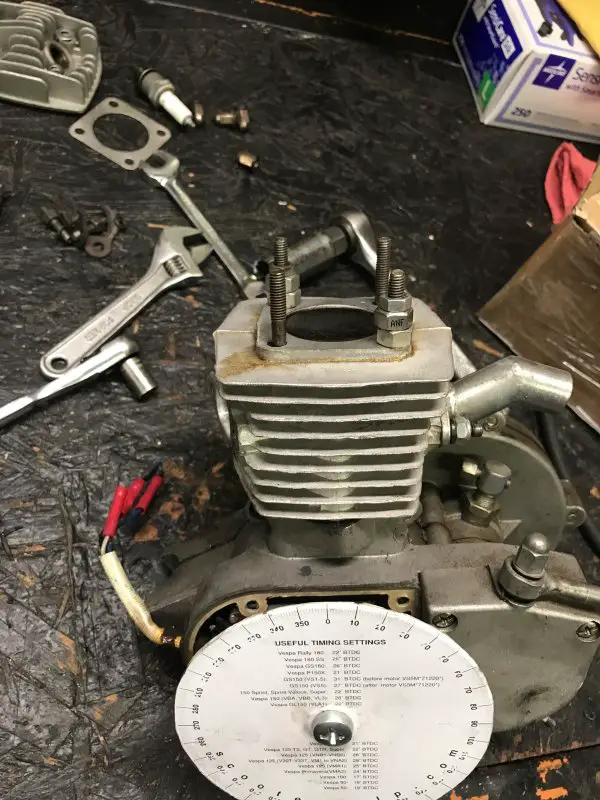

Here’s a 48cc with the cylinder compressing the base gasket for measuring.
