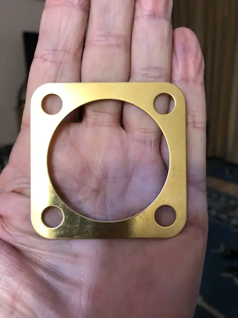

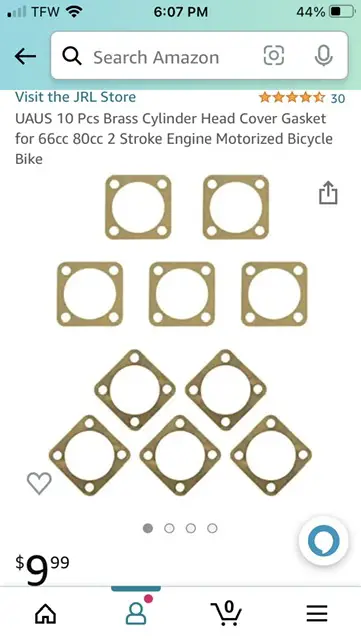

Had a slightly leaking head gasket so I bought 10 in a package on Amazon and will share actual measurements. They are for the “66cc” whatever that really is.
Center to center hole is 1.775 inches which is about 45mm. Bore diameter is 1.925 inches pretty much 49mm and the thickness is .024 inches, .635mm. They are likely some sort of brass as they are not easily bent. I put one on my motor and it seems to be working fine. Now I have 9 left, but buying 10 was less than some with only one. The dimensions in the listing are not exactly correct. Mine is working well.
I’ve bought gaskets in lots of 5 or 10 as well, I got piston rings too. A friend got clutch pads in bulk, 60 total. It seems that a lot of the cost of a single item is the shipping costs.
