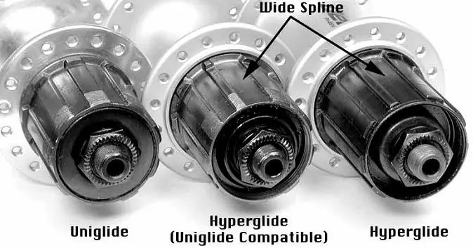

I don't have a lot of summer left, but while I wait for my #415, and my Manic Hub mount, I want to make sure I have a backup plan for making my bike finally work.
My problem has been the chain jumping. Even when putting a washer behind the drive sprock and dishing the rear sprock inward, the chain still jumped all over the place.
My plan is that if it still doesn't work, I will remove the cassette from the rear wheel and leave only one gear.
This way, the rear wheel will be much more to the right (with the extra gears gone). Then the engine and rear sprocket will finally line up, and it won't jump!
Edit: I did some research, and I would need to remove the freehub. One of the members here wrote this article!: http://www.sheldonbrown.com/freewheels.html
I would need a special tool.
Once I remove the freehub, however, does anyone know if it can be cut (to allow one gear) and replaced?
Any help is GREATLY appreciated!
