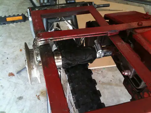

completed chainsaw bike!!!

Great build! My only concern is the drive roller is quite a ways out there and appears unsupported on the end opposite the engine. I imagine it gonna be hard on the crank like that. Maybe you could center and weld in a stub shaft of 1/2" dia., then add a pillow bearing to support it. Might be fine as it is, who knows. Just something to think about. I like it though, youre gonna have fun with it!
I agree.
Very nice, clean build.dance1

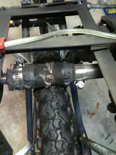

added the pillow bearing
it's just an idler pulley i had lying around the shop
added the tire around the roller for better traction
next step is to mount a larger gas can
i also bought a little exhaust pipe from oreillys today and ill work on a way to mount it eventually
After years of fabbing all kinds of stuff I hafta say I have never thought of using an idler as a bearing block! Cool!

thanks deacon! i really appreciated your advice on the roller alot. ill keep ya'll posted on its reliability and other modifications i make
also thank you cannonball for the advice on the pillow bearing i think its gonna increase the longevity of the engine

These other guys know a lot more about motors and building than me I just talk a lot more. I am curious to see how your rubber holds up. I put that on a pipe nipple and it didn't stay well, but I put it on a wheel in place of tire and I can' run it off or tear it off. I think that is because aluminum is more porous than steal so the glue held better.
its not glued on that well, im depending on the clamps. and if it doesnt hold up, who cares!!!!
the tire was free!!!
honestly i dont know much about motors either. mostly fabrication and BS-ing ;D
good im getting ready to start on my chainsaw bike again. I'm going to prowl the pawn shops in town to find the motor tomorrow. How many ccs is your motor.
the tire style roller got shredded in like 6 miles! hahahhahah
oh well
we now know one great way to dispose of an old tire

im gonna experiment with some other methods but for now the regular old steel roller will do
I use the roller. They say welding slag works but i think it would eat up the real tire.
