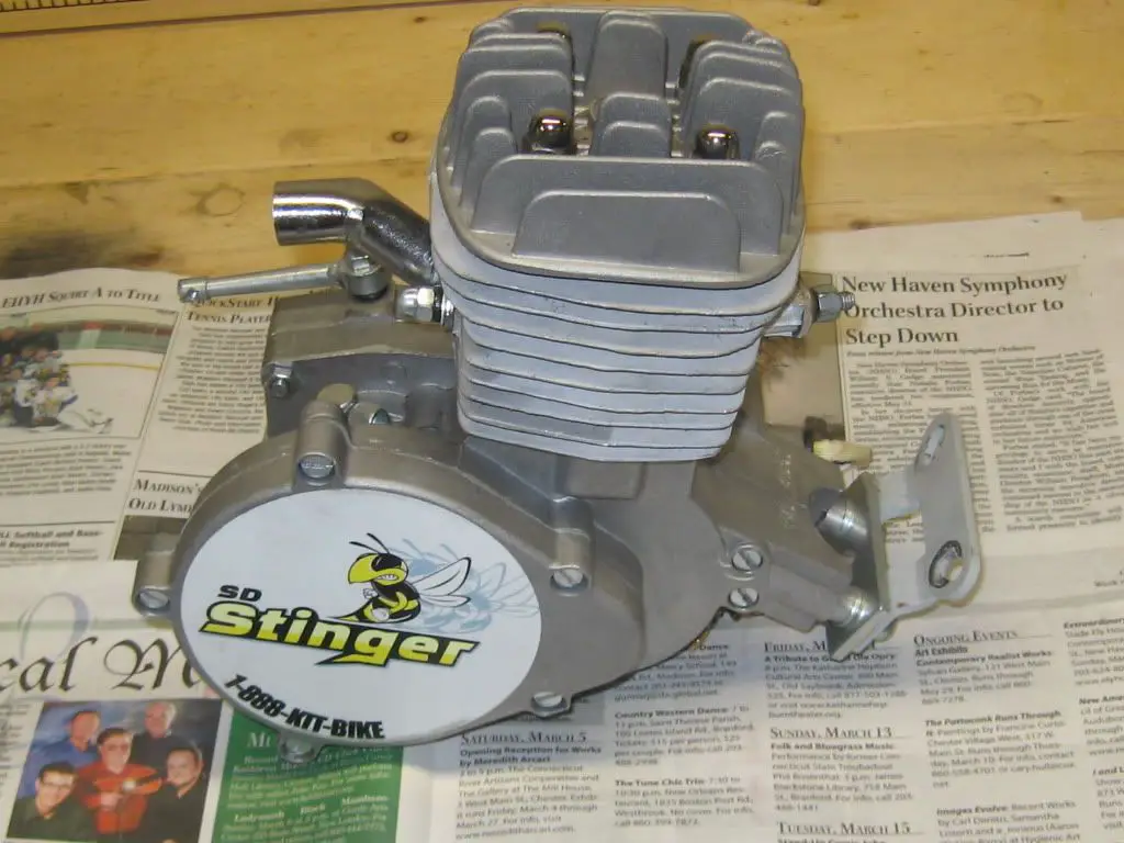

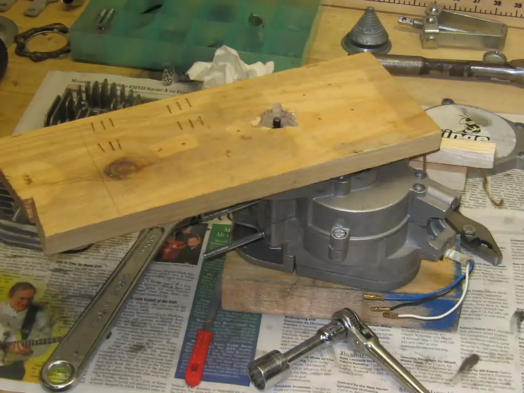

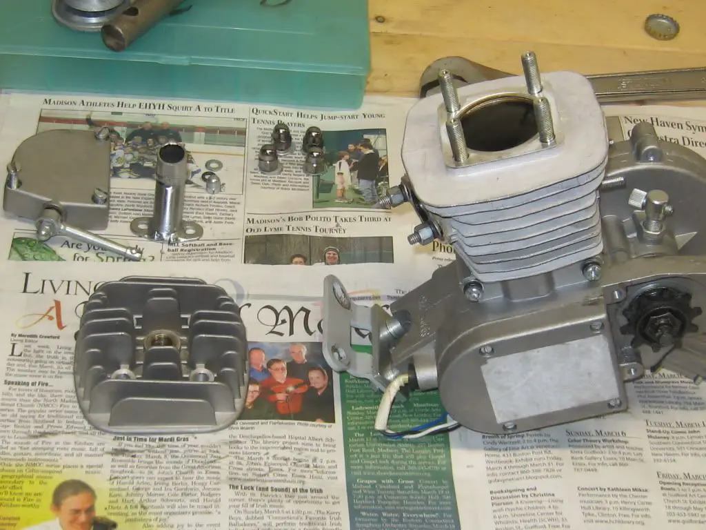

Alright, well today I got in the shop again because I went home for the weekend and, well, I tore down my little HT in preparation for a rebuild during spring break. I have figured out that the yamaha pw80 ran at a ratio of between 32:1 and 36:1 with its oil injector system. I'm going to get an injector from one of those for this build. I was amazed at how good the engine looked inside as I took it apart. Things look great on the jug and piston. The first pic is of my little HT this morning. Poor thing had no idea the world of pain it would be in by 7pm rotfl

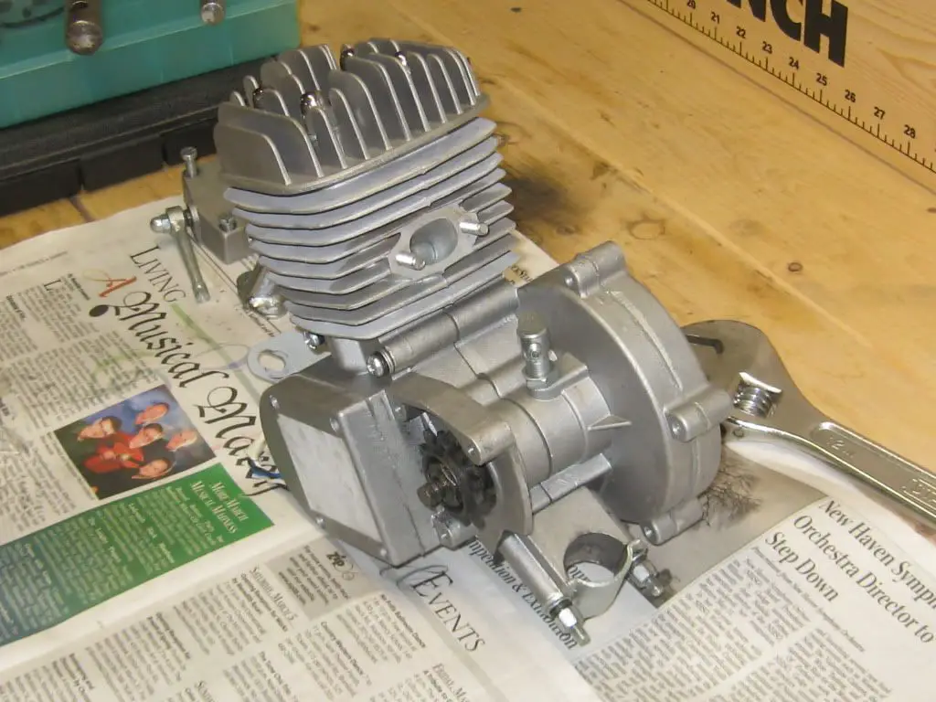

Here's how it looked by the evening :D

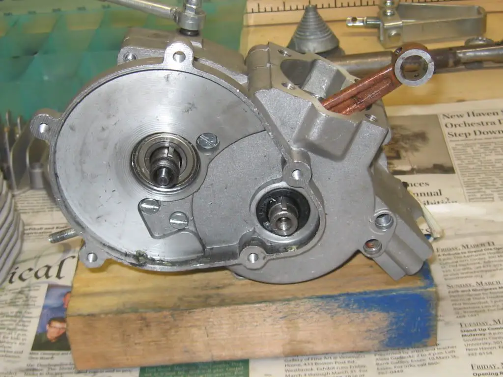

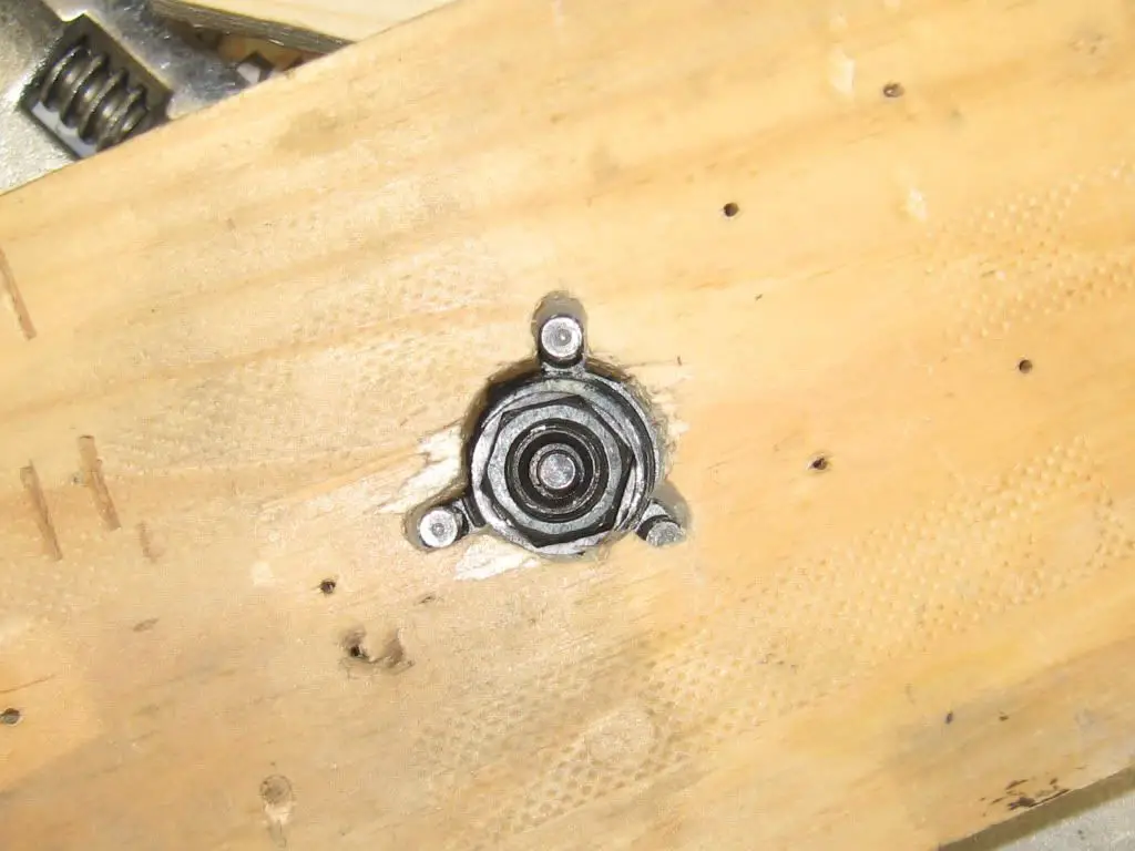

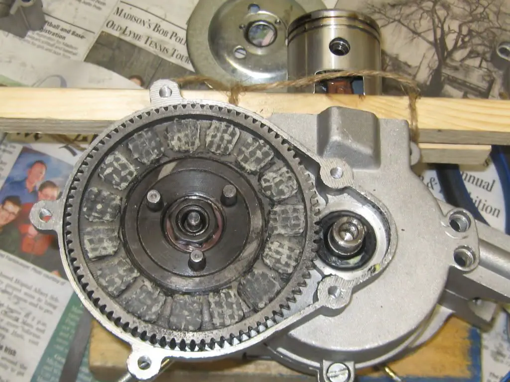

In the mean time, I figure I'll also talk about my experience with disassembling this engine. I would like to thank norm for a wonderful thread about clutches. I couldn't have figured this out in less than a week if I hadn't had that thread available to read. The pads on the clutch are only mildly worn because there are only 78 miles on the engine. While my dad was away on business someone stole our credit card number so we had to replace the cards. This meant a bad transaction with Dean at SCSW so it will take longer now to get the performance clutch pads. I'm going to try and find a source for the right skf bearings that I need. This is going to be an AWESOME engine when I'm through with it. Included are images of the clutch, the clever tool I used to remove various parts of the clutch :D, and an image of a VERY ugly spot on my crankshaft that I'll probably have machined out with a lathe so it doesn't throw off balance.

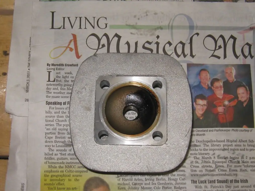

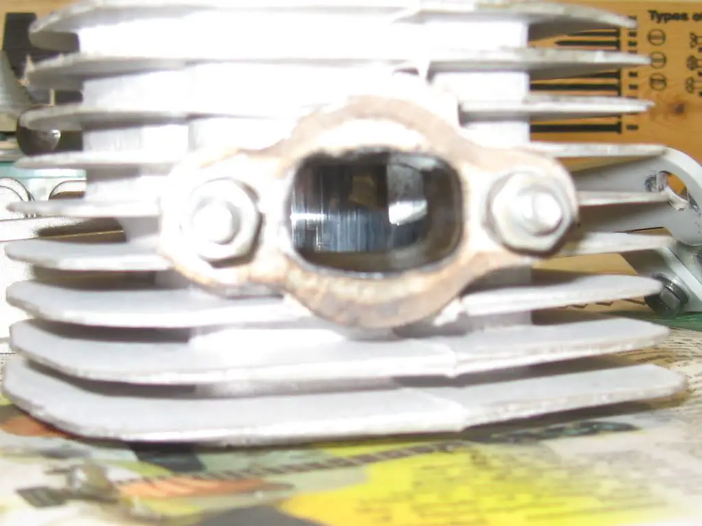

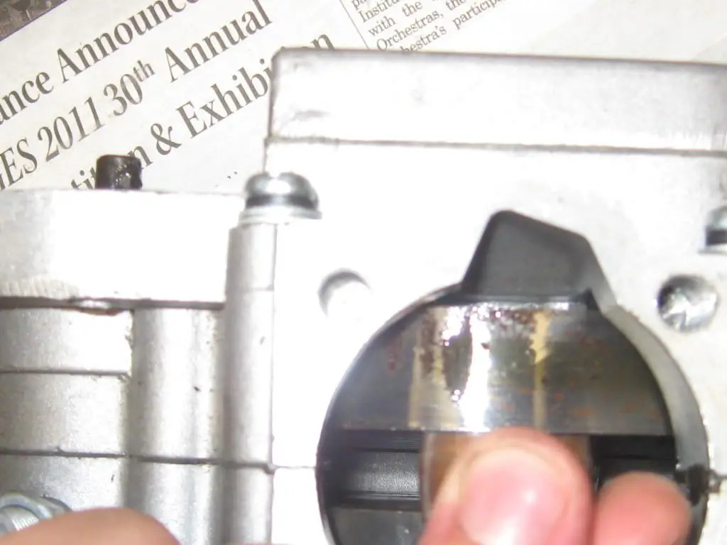

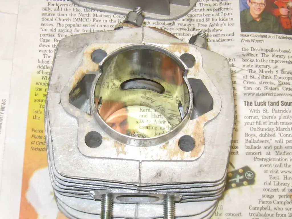

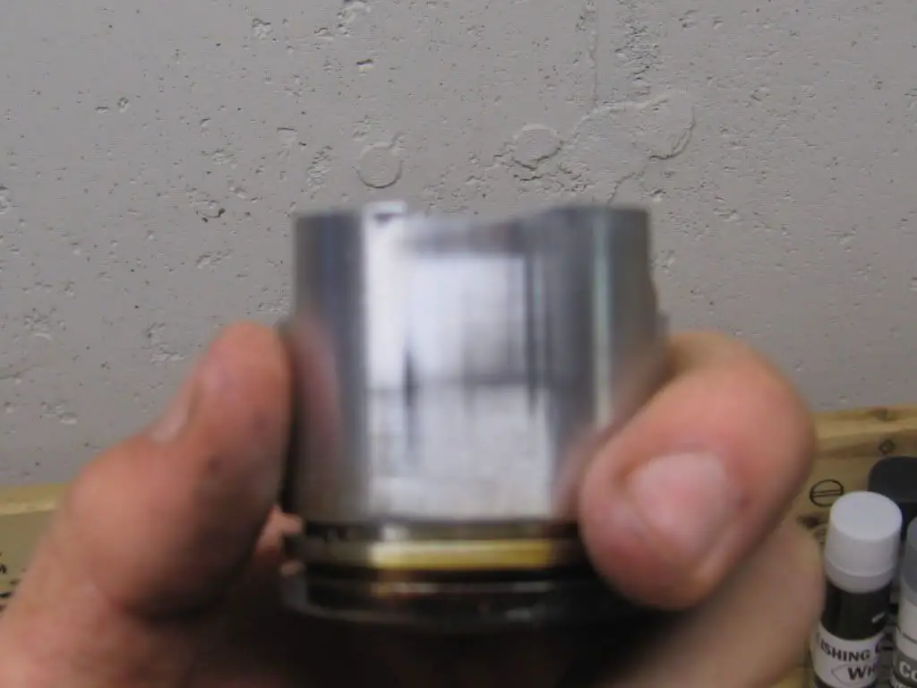

Last are some pics of the top end. The jug was really bright and shiny on the inside still. I'm going to port and polish it, and treat it to better gaskets where and when I can. About 2 mm of my intake was blocked by the bottom of the piston skirt, so I filed that down today and also put a slight chamfer on the bottom to improve lubrication in the cylinder. The exhaust port is really clean, and the dome on the head is free of damage. I'm going to polish it up nice and bright. I also plan to get my piston skirt coated since it only costs $18 to do.
