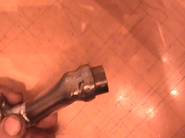

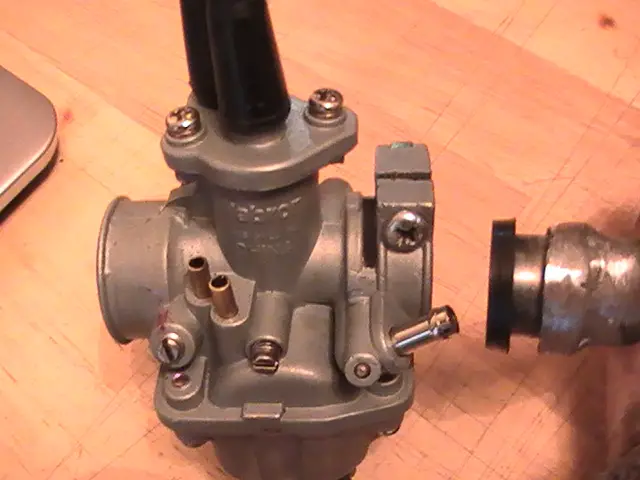

Bike running fine on the stock HT and looking at a CNS carb and intake that don't quite work together.
So I welded a sleeve to the intake so carb would fit better.
Even with the plastic washer that came with carb would not work with this intake. We ordered them from the same company? Do you think they knew?
Sure you can sell the carb and you can sell the intake but will they work together?
Which is the most important thing about them, working together!! (Seinfeld)
Enough of that. I have it mounted now so, this is what is happinin.
Leaving the house the bike ran ok with me putsin around.
When the bike get's hot it ran like poop, falling on it's face.
Limping it home noticed that near the carb the intake was freezing up. Starts to get warm half way and hot at the head. Is that normal? Throttle even with the clutch in bogs bad, and will not come up on rpm at all? What the help.

I adjusted the C clip to it's best setting I could find, one before the bottom. With this setting bike still would not drive its way out of a paper bag. But ran 22mph with nice idle.
First change I cut the intake down a little bringing it out the other side now.
Much better with that change. Now starting to feel some power again.
Again the best setting to the C clip one from the bottom was best. Now running 34mph with some get up and go. Shorter was allot better, let's cut it again!!
The CNS carb is a little bigger than my HT and would not work with stock intake. It hit the clutch lever and did not fit carb. Cutting/welding the $20.00 intake fun!! Back with the shorter intake after dinner.

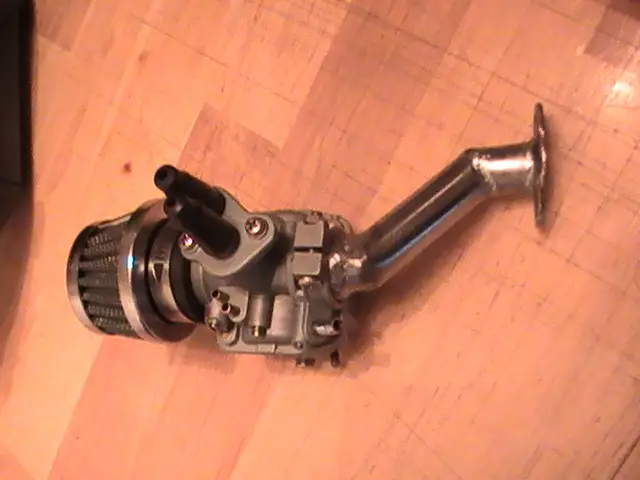

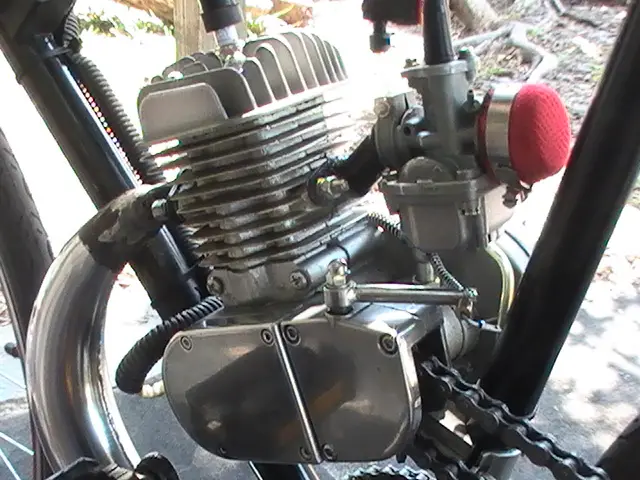

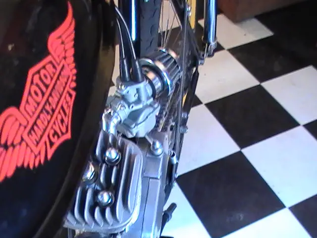

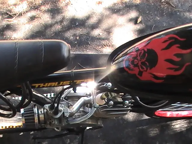

Here is how short I made the next intake, looks like stock but not.
I could come down very little more but I like having the clutch room.
After doing the intake and checking carb setting but no jetting.
The best spot for all three intakes was C clip one before bottom? Thats here in Florida.
Three times a charm, bike running better than ever now.
Nice steady 40+mph on the new cats/eye puter 70/kl with some throttle to spare. I like the new carb and intake I made.
You could not use a straight intake and that carb, needs a little up lift. Hope this helps someone besides me!!
