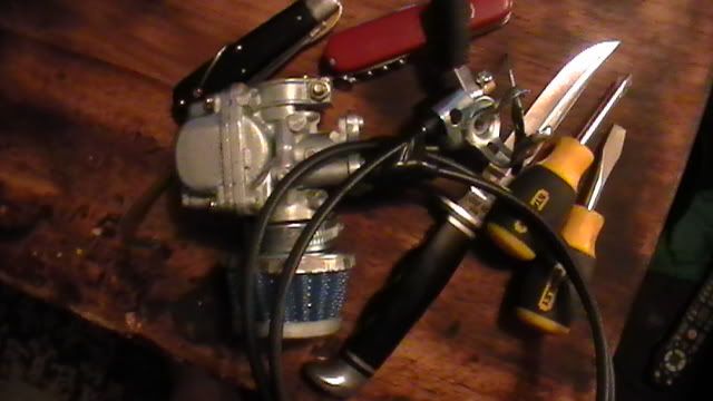

the carb rocks
sure mine didnt work either the first time but from the little I know about carbs it was too rich
so I soldered the jet and drilled a smaller hole until I found the size that works
most here say it comes too lean, well mine was the opposite
once I figured that out it pulls better then stock, around the same top speed but I needed the extra pull it does, and I have solid proof of that claim using a cen clutch no chattering from a dead stop unlike the stock carb would do
thats the only proof I can measure though I use gps for top speed and its the same
I would invest in a set of micro drill bits and either upjet or downjet one size at a time until it seems to work
You can buy jets but they are expensive
here is a video I did just yesterday showing it works and idles great
believe me I was also very disappointed when I first received it and gave up. Only messed with it because I had nothing to do. Glad I did.
http://www.youtube.com/watch?v=MYZ0nCc62GU
I know little about carbs, only how to replace the parts on them. And the basics of how they work. So that may have helped me figure the jetting easier then someone with no idea what to do. You could always take that info to a small engine repair shop and they could help get it running too, not much to it
